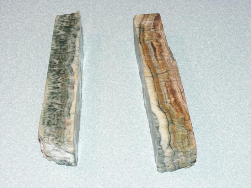

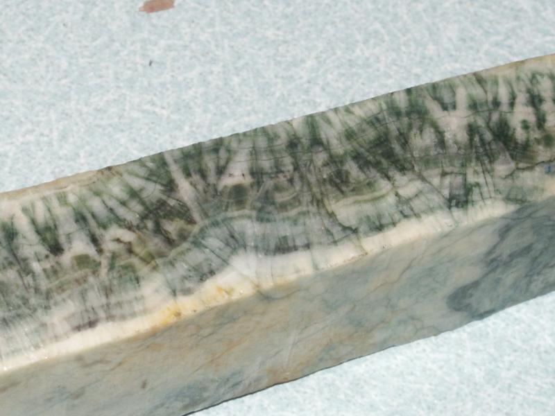

Hello,
Here is one of my projects that I started about 7 months ago.
I am going to try to make a pen from a piece of real stone that I bought off eBay about a year ago.
I bought this as Mexican Onyx, which I guess is Calcite. It is supposed to be #3 on the mohs hardness scale, so I believe that I can turn it with carbide.
Has anyone ever tried this before?
This was one big piece when I got it, and I just had a friend cut it into four pieces on his diamond saw.
If I am felling ambitious in the next week, I will cut it to length.
I am hoping That I will be able to drill it with a carbide drill bit with coolant.

It should be doable, depending on your lathe and tooling.
One recommendation. Use a cheap (HF) diamond file or a die grinder to round the corners and make the initial rough cuts. Stone is really hard on carbide tools. It can ruin carbide skews, AND it will chip out the inserts for carbide cutters.
Opposed to my original thinking, like petrified wood, I had much better results cutting at higher speeds than lower speeds.
Oh yeah, one other recommendation.....WEAR A FACESHIELD, respirator and a cup!
One other thing. Get yourself the drill bits necessary for the hardware in either Titianium coating or stone/tile bits (if you can find the correct size). After one use the bits are likely shot.
