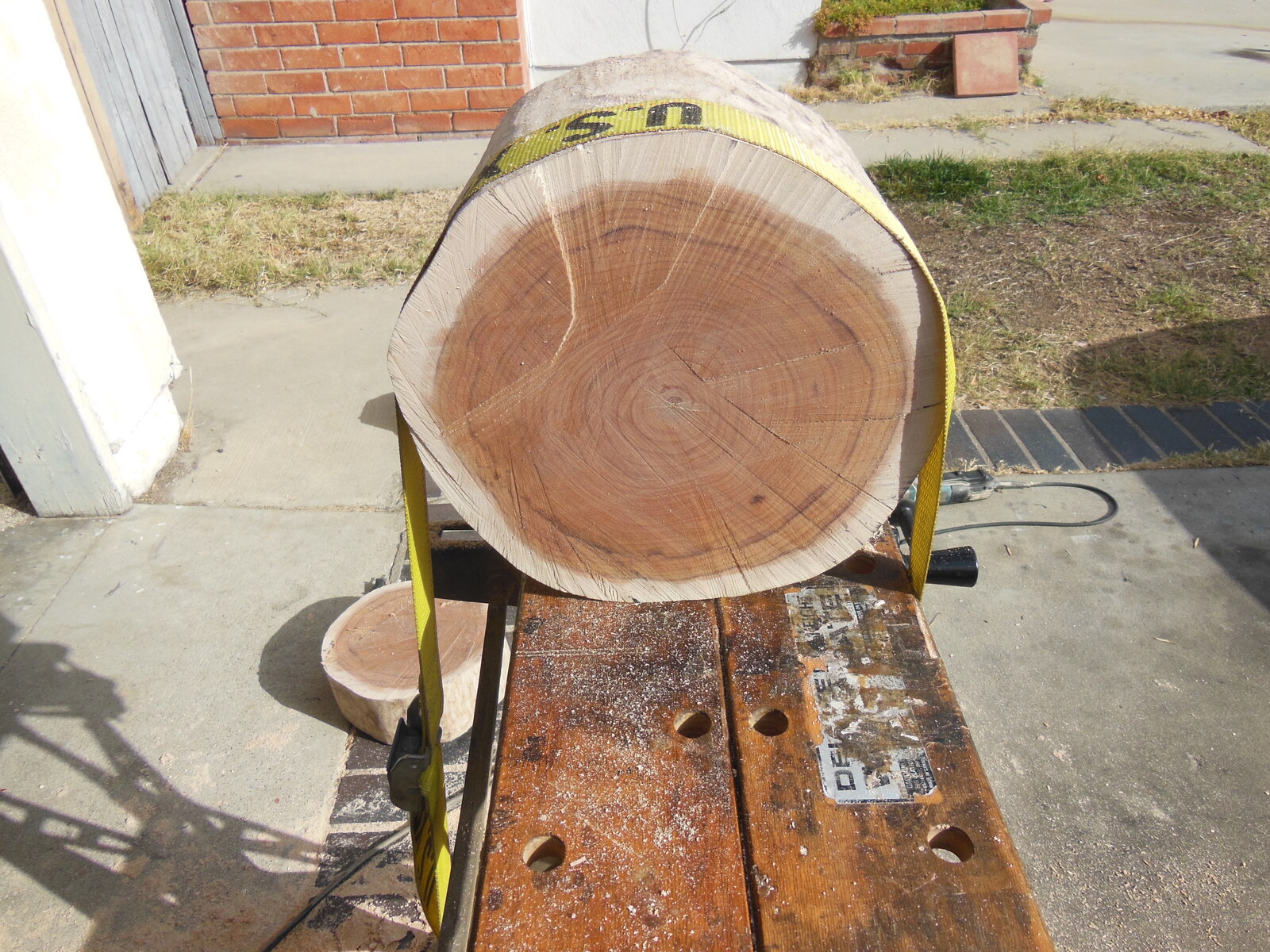

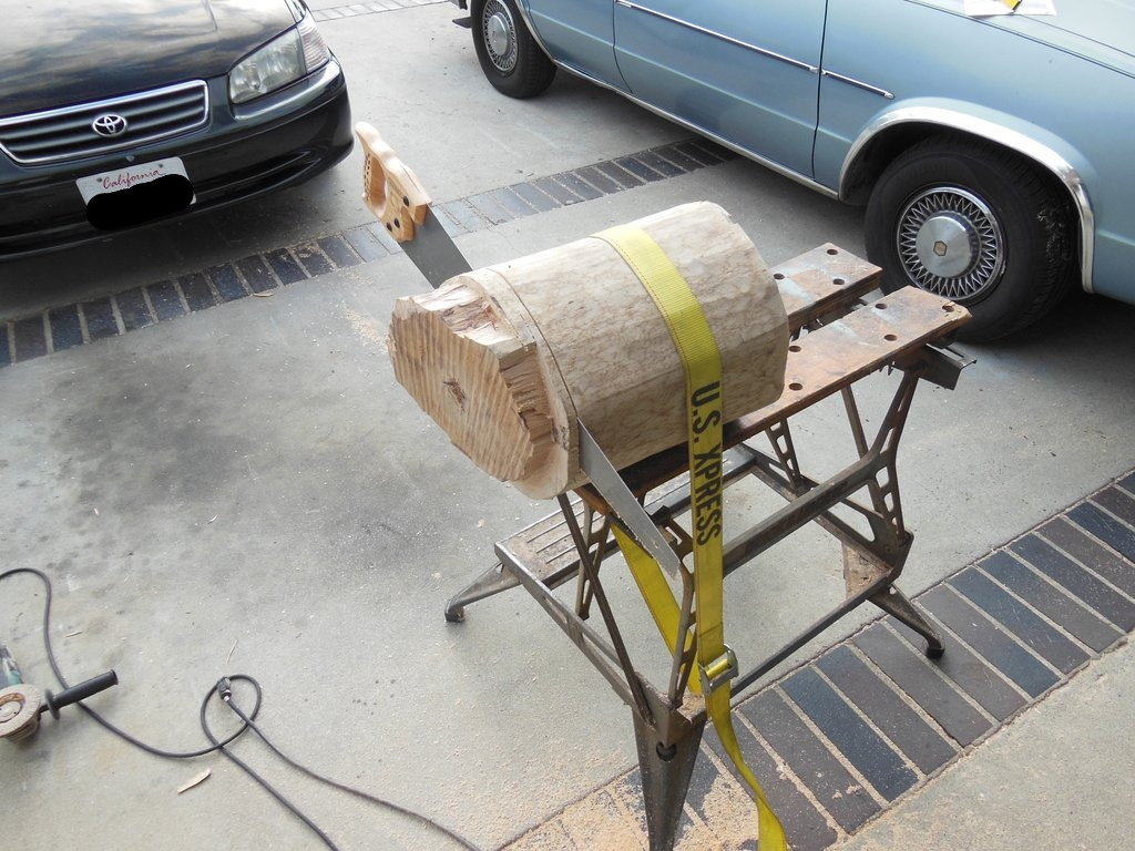

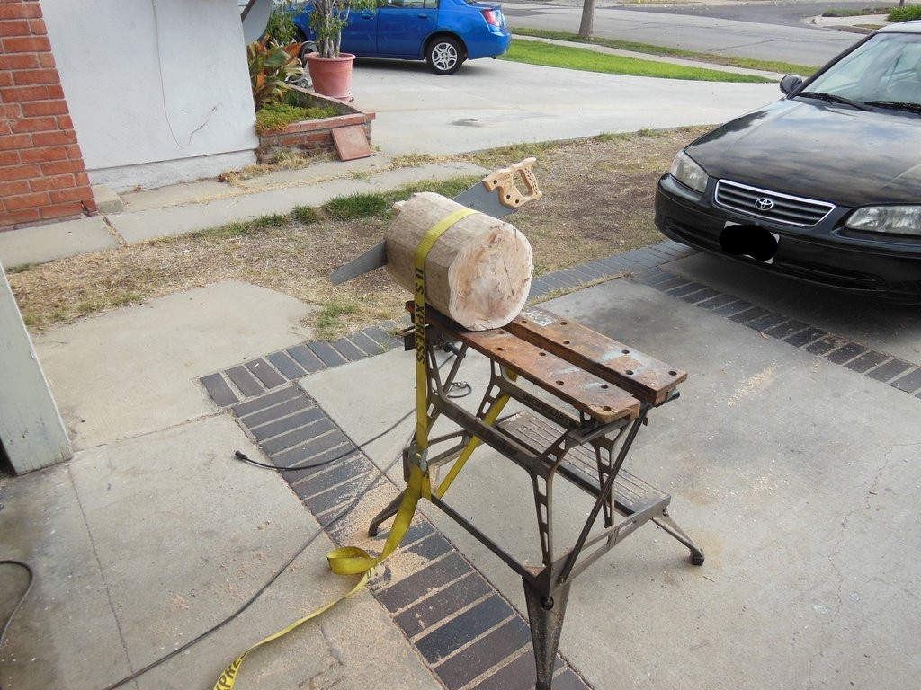

So my girlfriend and i decided to do home made presents this year for Christmas with a $40 limit, she also mentioned she wanted a bowl. So i went driving around one day and found some logs by the side of the road and i picked up this guy. I believe it is paperbark Birch.

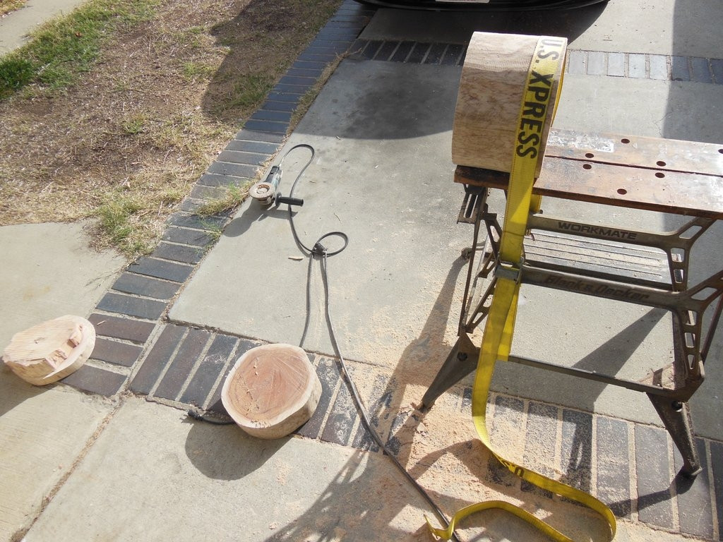

It was freshly cut, unbelievably heavy and huge, so i had to make it a bit more manageable.

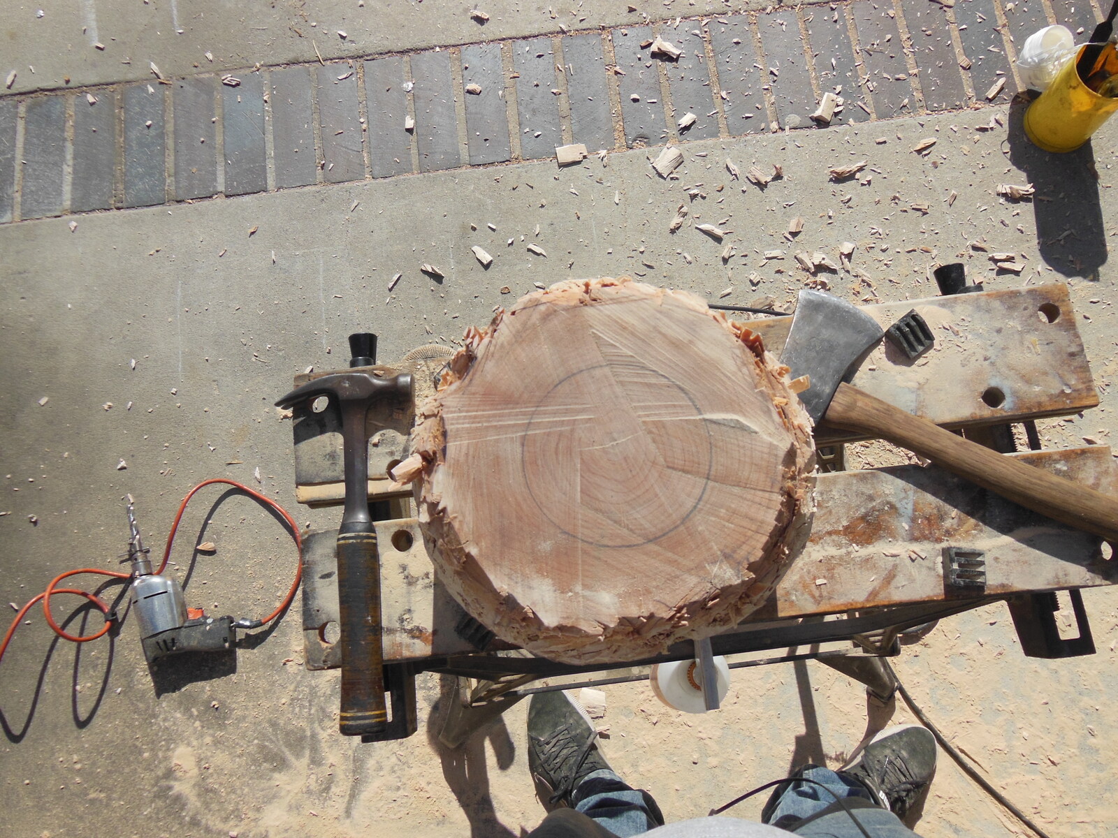

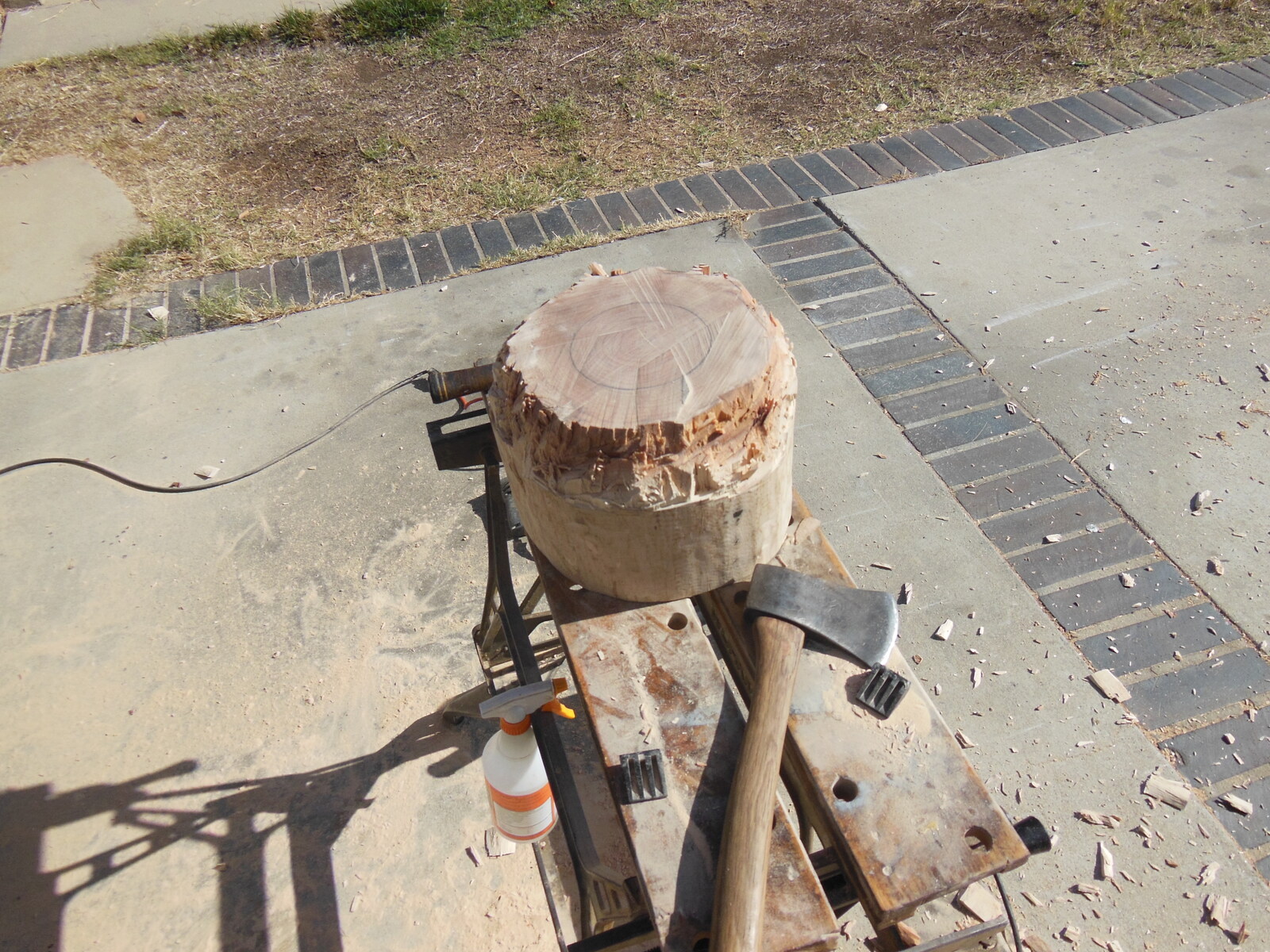

After getting it to size it was time to start chopping away.

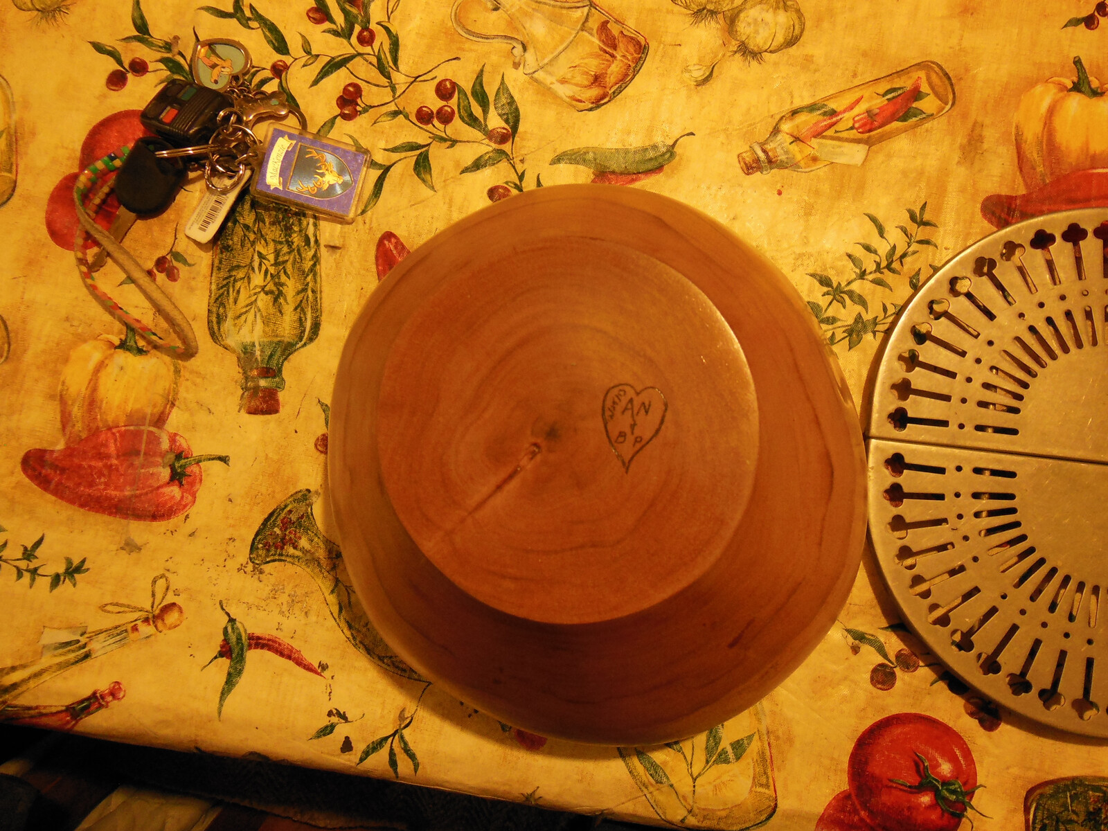

This is the bottom of the bowl.

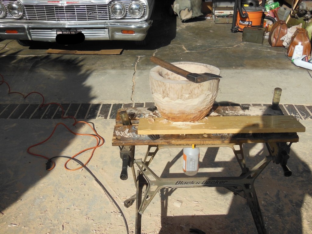

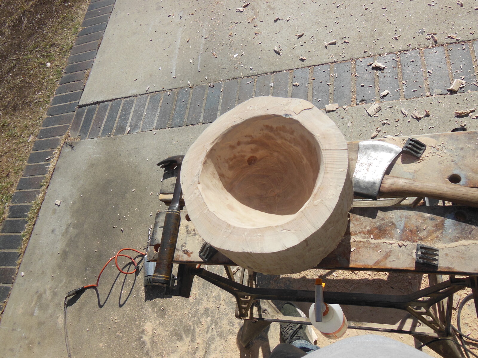

The top! Once i got to this point i was beginning to rethink my plan. There was a lot more meat to hog out than i anticipated.

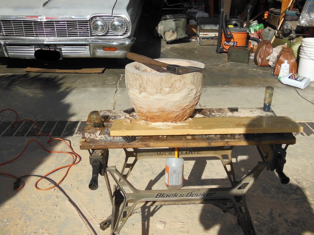

It took quite a few hours to get to this point. I continued chipping away at it until i got to about a 1/2 inch thickness around. Then i broke out the sander and started smoothing it out.

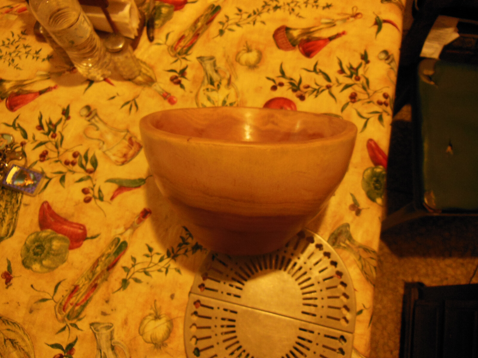

Once i got to a point where i was semi-happy with the shape i still needed to dry out the wood. I didn't have a half a year or a kiln to quickly dry it, but i did have a microwave. I read about other people drying wood in there with mixed results so i thought i would give it a try. I began writing the weight down each time i microwaved it. It's hard to believe but when i was done this bowl lost half its weight in water. It only had about one or two hairline cracks also, which i filled with gorilla glue epoxy ( it's clear and dries very well.

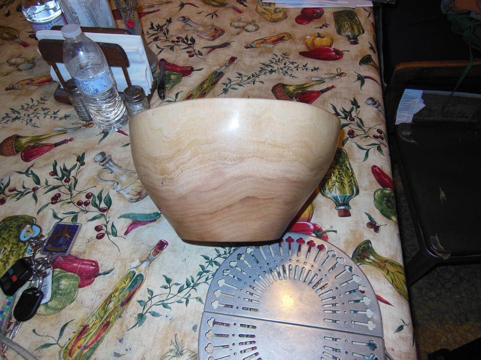

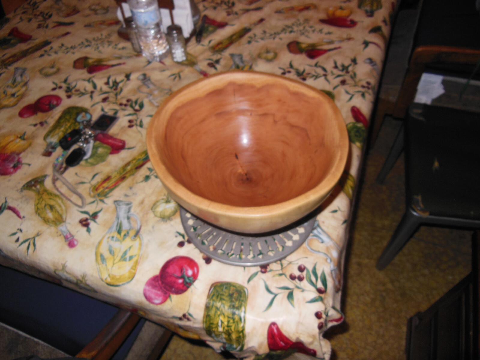

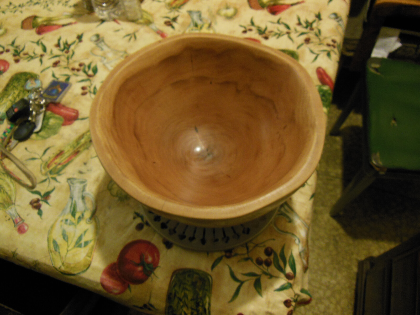

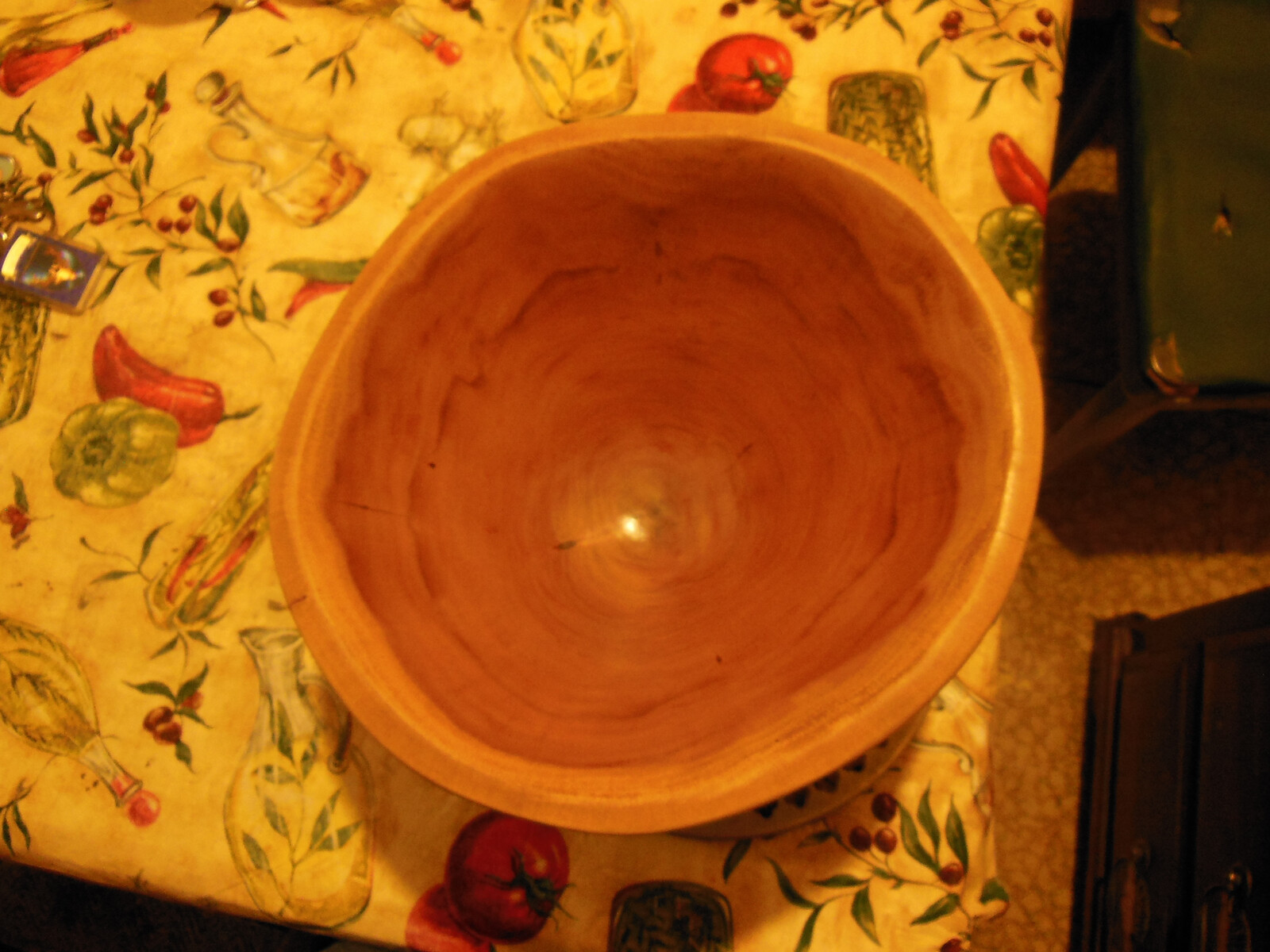

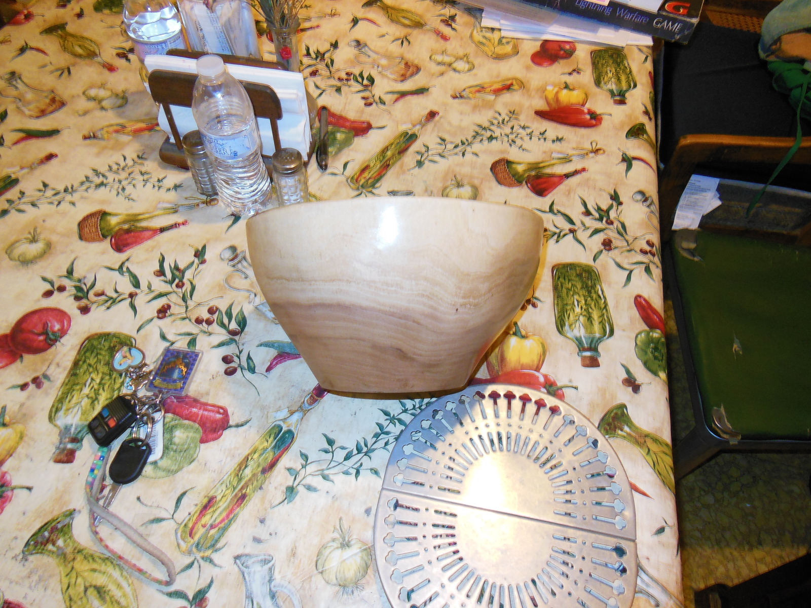

here it is after final sanding and finishing. I used Danish oil and wax to seal it.
It's not perfect, but it's a bowl.
