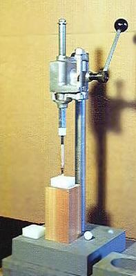

Before I found the Grizzly press, I was using a homemade contraption made from an adaptor that is supposed to make a drill press out of a handheld electric drill. Right now it is in my shop, while the Grizzly is inside the house. I use whichever is closest at the time. Of course, cost was next to nothing!
<b>Image Insert:</b><br />
<br />
