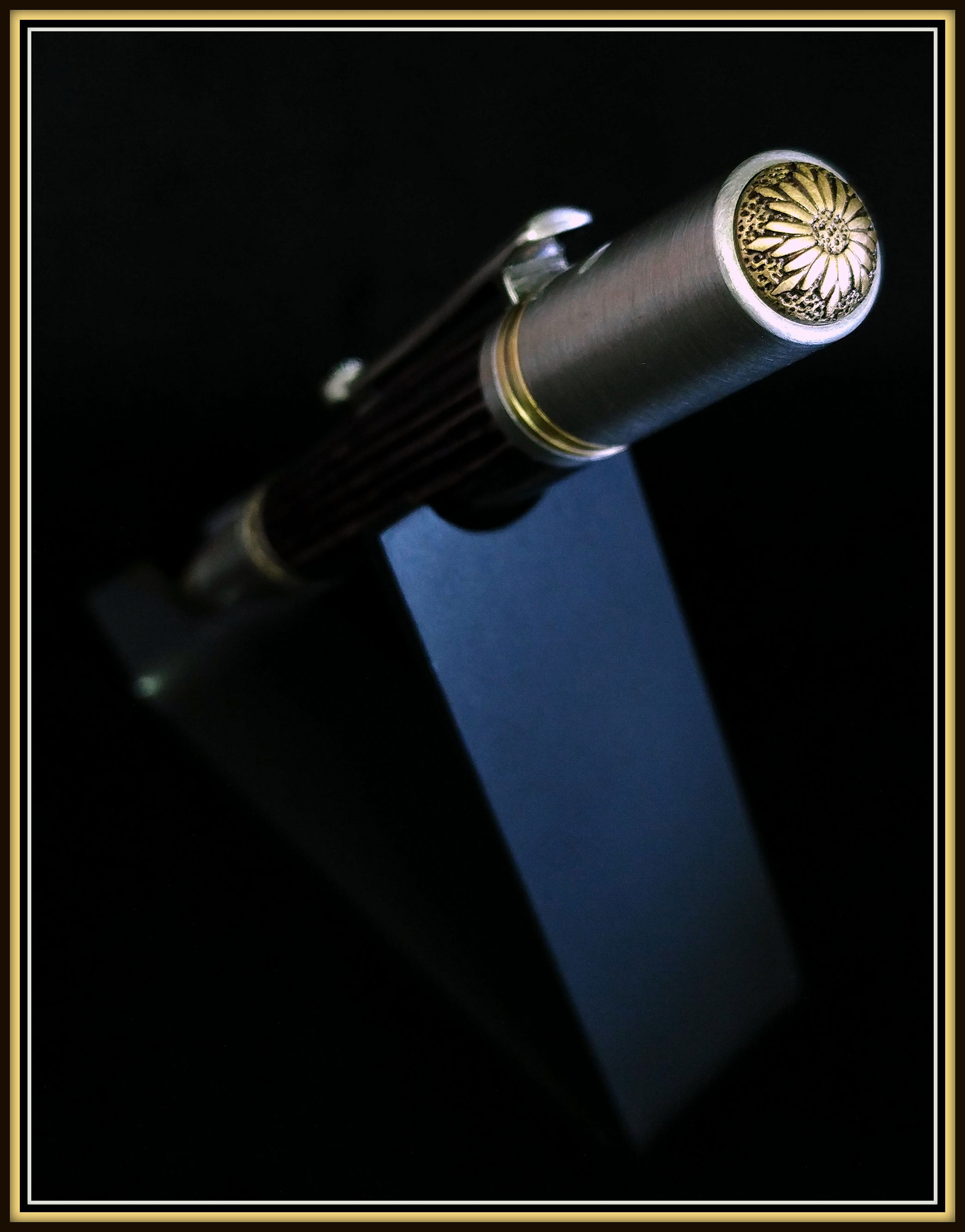

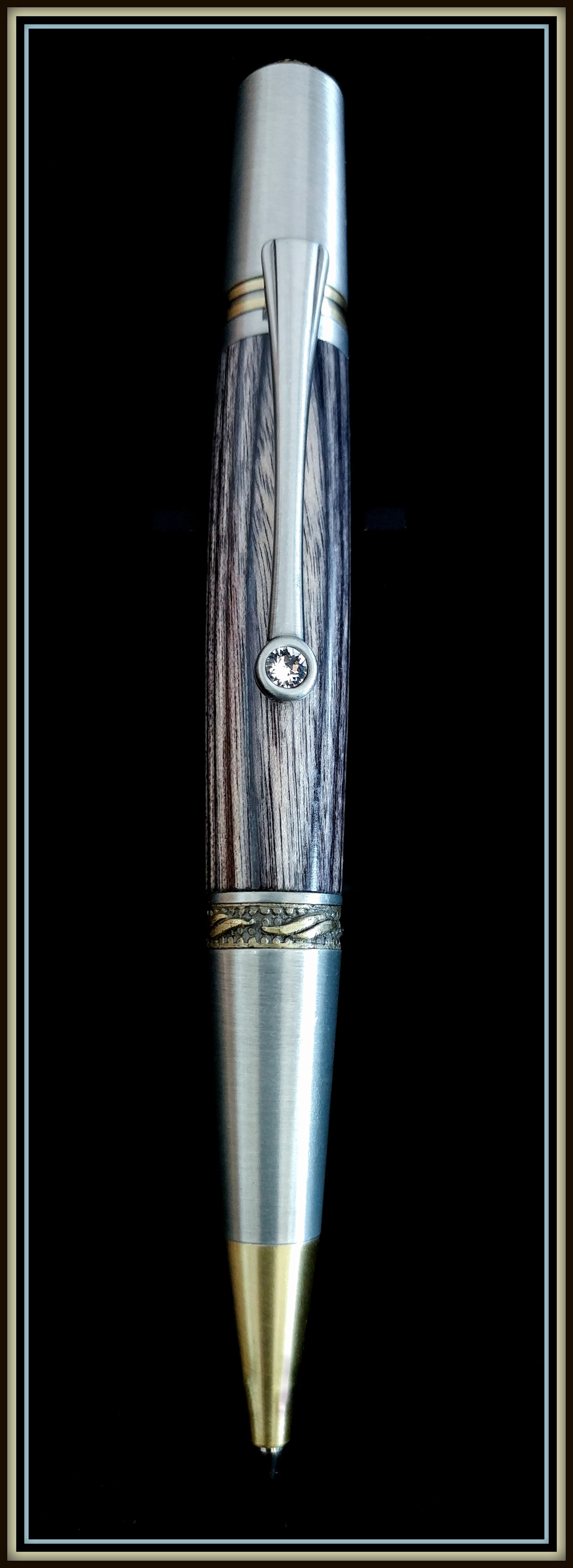

I paired this Majestic Squire in Antique Brass with a Woodcraft Blue Spectraply blank. It's surprising how nice this fancy piece of plywood turns out. Polished up to 400 grit, wiped with BLO, then multiple coats of thin CA glue applied to a piece of shop towel after adding a drop of BLO (roll the towel and cut into 1/2" strips; use a clean surface with each application). Apply and burnish each layer at 1500RPM until the CA warms and takes on a sheen. Quick polish with MeGuiar's "PlastX". Easy peasy!
