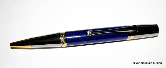

New Majestic Squire Black Ti/22K gold finish from PSI,
in dark lapis Tru-stone from http://www.randbcrafts.com/.
I'm undecided about the kit, but really like the blank.
This is my first show off post since last year, so go easy on me!:biggrin:
Comments welcome.

You turn too?!?!?! I didn't know you were mulit-talented.
Nice job but I too am not too wild about the pen.
Vern
As for the kit, I think it would look better with Rhodium instead of the gold. There isn't enough of a difference to me between the Squire and the standard to pay double the cost.
The pen though, looks very nice.
Nice job.
Maybe the Squire would look better with a lighter colored blank. I'd have to see it that way too to decide if I like the kit or not.

Here is a mini-review, if you will entertain me for a moment.
I am undecided if I like it enough to ever order more.It just hasn't "hit" me yet as love at first sight.
The embellishments are a lot to place on a smaller pen, there is almost not
enough room for all the glitz. 10 gallons in a 5 gallon pail syndrome, maybe?
My thoughts after making this one, are that it is a pretty decent looking kit.
The plating is pretty good, but not quite as polished as plating on an emperor, or such.
It went together fine, but transmission appeared really lightweight (IMHO), and twisting is not very smooth.Maybe it will break in.
The refill it came with was a no-name, not sure about that. A Schmidt would have been nice for the kit price.
Also, the refill came with a loose spring, ala parker refill, that was to be put on the nose of refill.
Wonder how many customers throw that spring away, it being stuffed on the refill instead of tail end?
Overall, it looked great in the bag in kit form. As I laid it out to assemble,
it kind of hit me that it is just not worth 20.20 (2+ price) of my money.
There are other kits available for the same basic money that I will buy
first if I'm buying for myself to make.Customer requests are a different story.
Overall quality and looks are good, but it would be a lot nicer in my mind, at a price point of around 12-14 dollars.
Wife wants it already, but I have told her it's a bad habit, and she should try to quit.:rolleyes:
i like the kit as well. I mostly make the two piece pens but this style seems to be popular for my lady customers so it gives you a higher end kit option for them. Just my opinion.
l don't mind it Johnny! is there much meat left on the tube after turning.:biggrin:
Thanks, John!
There is quite a bit of thickness on this one, it takes a 3/8" drill
and finishes at both ends just under 1/2" (.496 exactly).
that's 1/16" per side left.
Probably a good candidate for clear casting over things.:biggrin:
