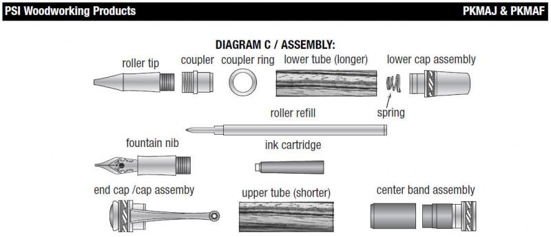

I have ruined two nice Amboyna burl tops for my Majestic Pens...
Can anyone tell me what I'm doing wrong...?
The attached photo shows Center Band Assembly (CBA) in two pieces; however, the plastic portion supplied is a single piece...
Instructions say to press the assembly into the CBA into the Upper Tube...
The CBA is 1 3/4" in length and gets "really-really" tight when pressed in about half way...with additional pressure it can be forced in completely...but that's when the problem occurs...
I have ended up splitting my tops (the Amboyna burl)...
Are you supposed to grease the thing...?
I see a lot of Majestic kits out there and know they work, so I must have a problem I can't figure out...
PSI was nice and immediately sent me replacement parts...but I don't want to have another mishap...
Thanks in advance...

The instructions are correct. It may look like one piece, but you can actually pull it apart. Nobody else mentioned it yet, but make ABSOLUTELY sure that your blank and cap assembly are straight when pressing them together.

Q: Does the assembly have to be this long...? It looks to me like you could cut it in half and just use a shorter portion...

Consider this, the inside of the brass tube is smooth, giving the black delrin sleeve a smooth insertion. Sanding or roughing up the brass eliminates this smoothmess and you are correct, it has something to GRAB, the delrin sleeve! I wouldn't sand.
The sleeve does not have to be as long as it is but without it the fountain nib could bang against the brass tube everytime you capped the pen and that;s not a good thing. The sleeve is long for a reason.

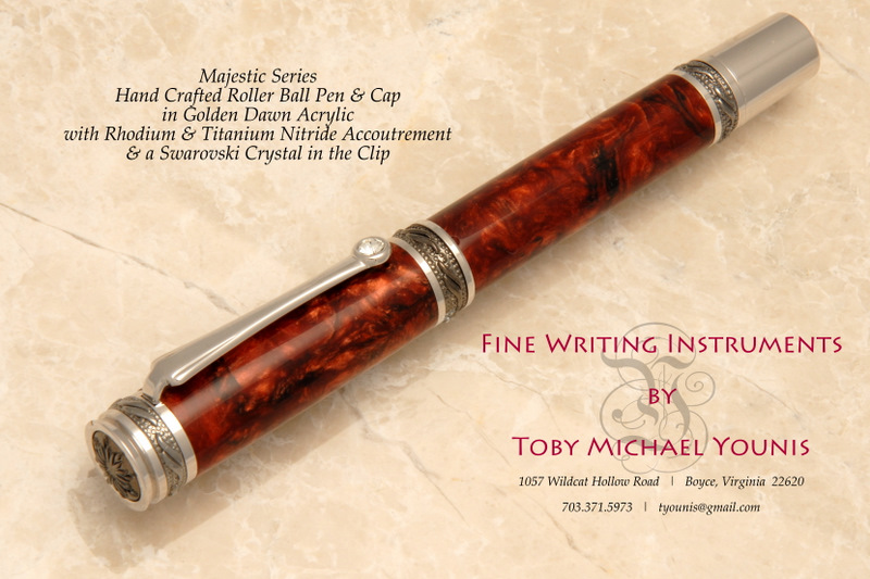

Assembling a Majestic
I just finished my first Majestic after having read this thread several times.
Here's what I found out:
1. Using the PSI milling bushings prevent the brass tubes from scoring, but they also prevent them from getting cleaned, so I ran them through with several cleaning patches. I put a little acetone on the patches. I cleaned them until they were relatively spotless and shiny.
2. To me, the smoother and cleaner they are, the easier it's going to be seating the delrin, so I don't think I'd either sand the inside or run a gun cleaning brush through it. On the other hand, I've only been at this for a month, so far be it for me to contradict the more experienced in the forum.
3. I did notice a burr formed on the inside of the tube at each end after milling. I could feel it with my finger. I smoothed it using a dowel wrapped with 600 grit sandpaper. I made sure that I didn't scar the inside of the tube while I removed the burr.
4. Finally, just before I pressed the delrin into the brass, I rubbed some beeswax on the delrin, then smoothed it with a clean cotton cloth.
I use a PSI pen press, and held my breath when I did it.
It went in fine and smooth with progressively greater pressure towards the end, but I never felt I was putting enough pressure to cause my acrylic blank to crack.
I've posted a picture of the finished pen here:
Good luck.
Let me know if you have any questions about what I did.
Regards,
t.
Ed
Some kits the instructions do show two pieces but the parts are assembled when you get the kit.. or at least have been sorta put together... otherwise you may be short a piece of your kit.
