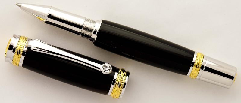

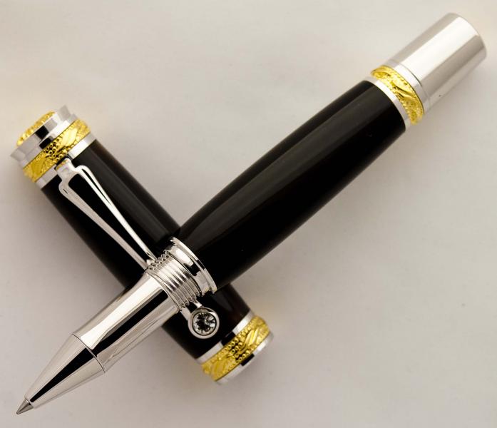

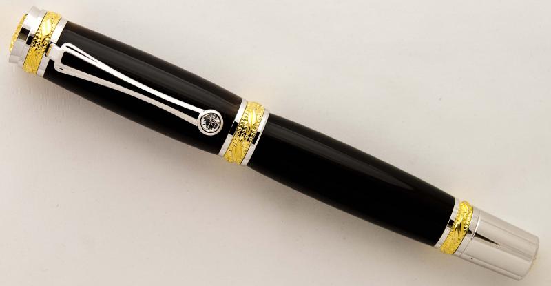

Made it this A.M. It's Gemsbok horn on a Rhodium and 22k Gold Plated Majestic Rollerball. The Gemsbok Horn was a generous gift from Terry Finney aka terryf. Followed the turning and finishing techniques per Terry. After the first 5 to 10 mm off the surface, the horn started to turn almost like an acrylic. Sanded slowly from 150 to 600 grit, MM (wet) from 1200 to 12000 grit, followed by HUT Plastic Polish. Comments welcome but most of all thanks for just looking. Doc
Terry, Thank you for the Gemsbok Horn, turning and finishing tips! Regards, Doc

Like Roy said, very classy. Better yet you photographed it on white too! :biggrin:
Mike, Thank you. I'm starting to like photographing on white because you can see the fit, finish and fittings themselves better. The black background has it's place but with this particular pen on black....all you would see is the kit:rolleyes:. Regards, Doc
