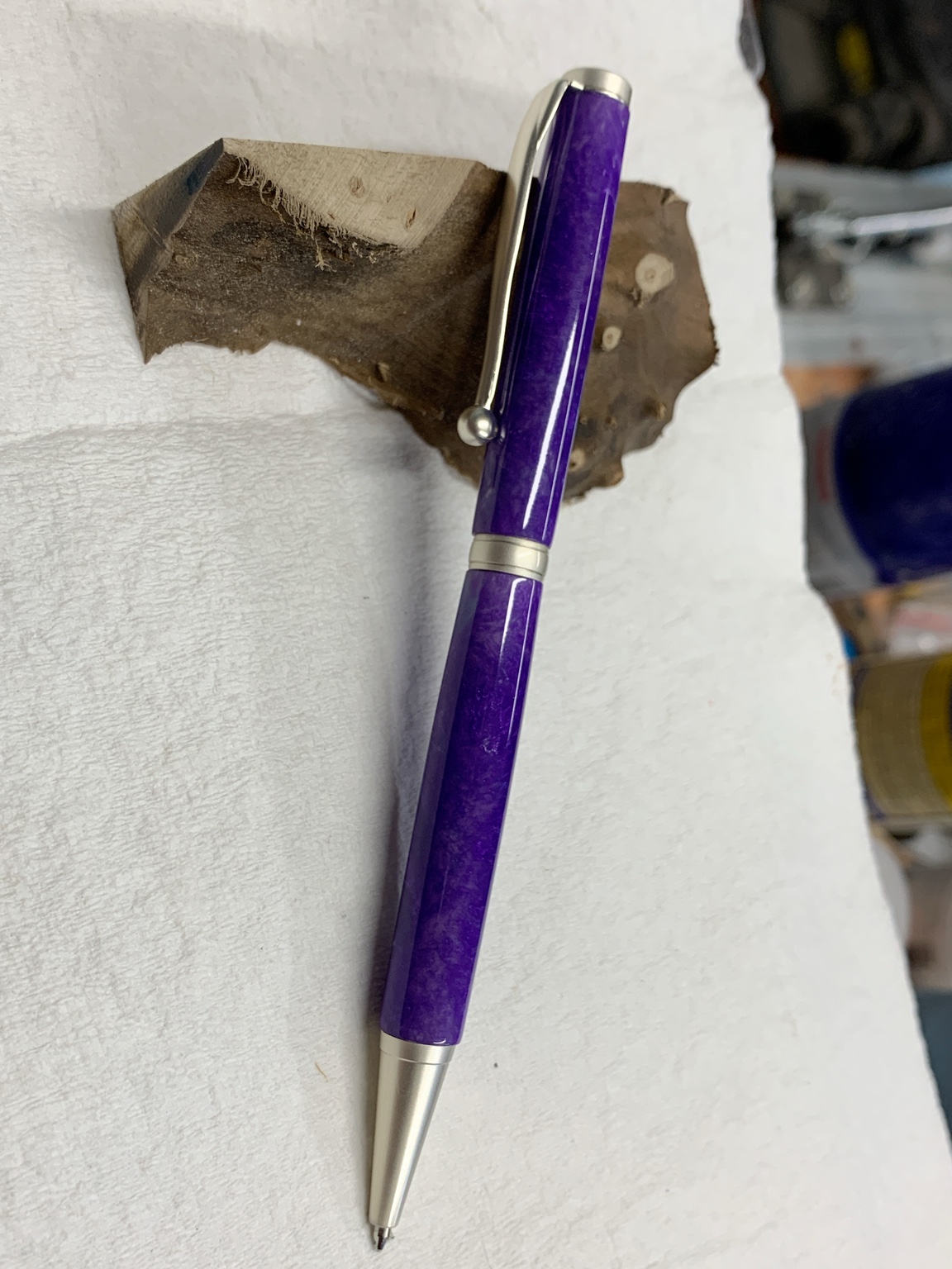

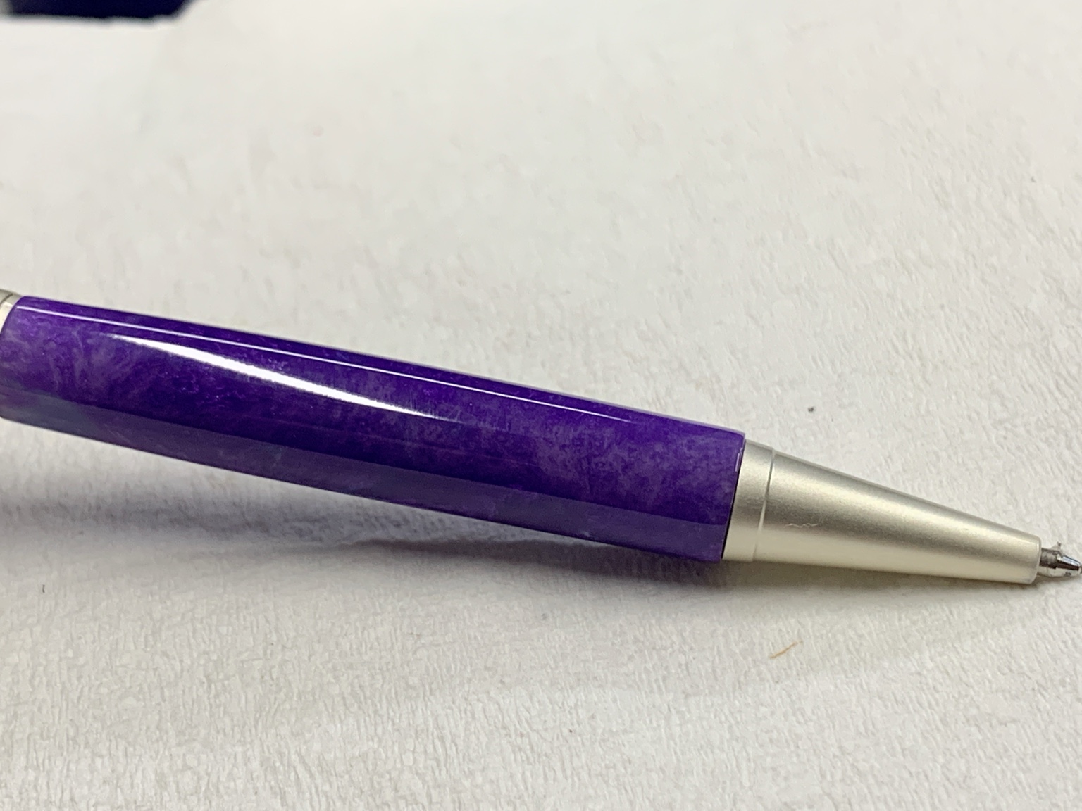

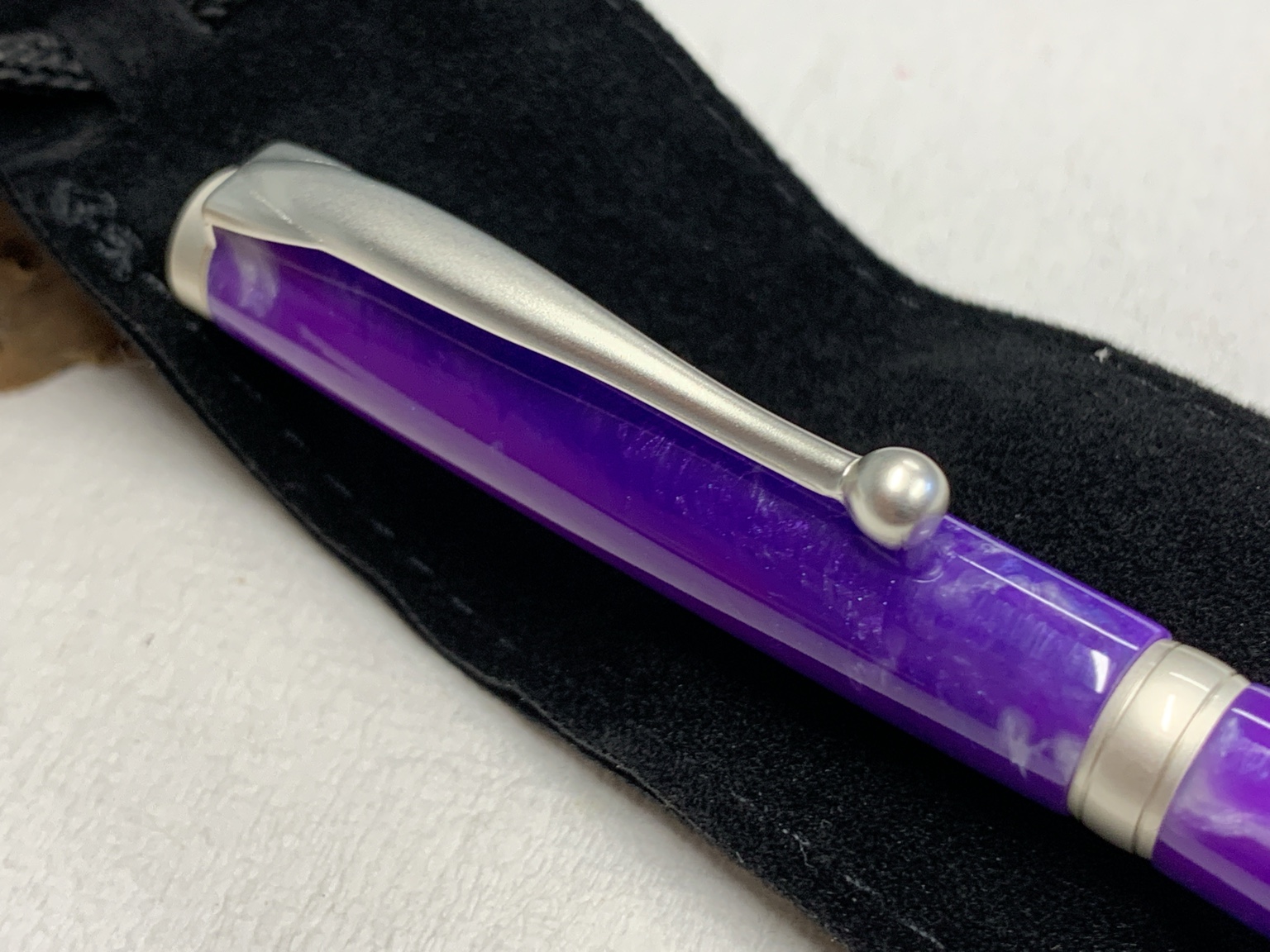

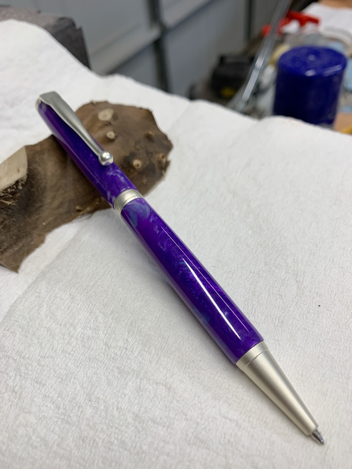

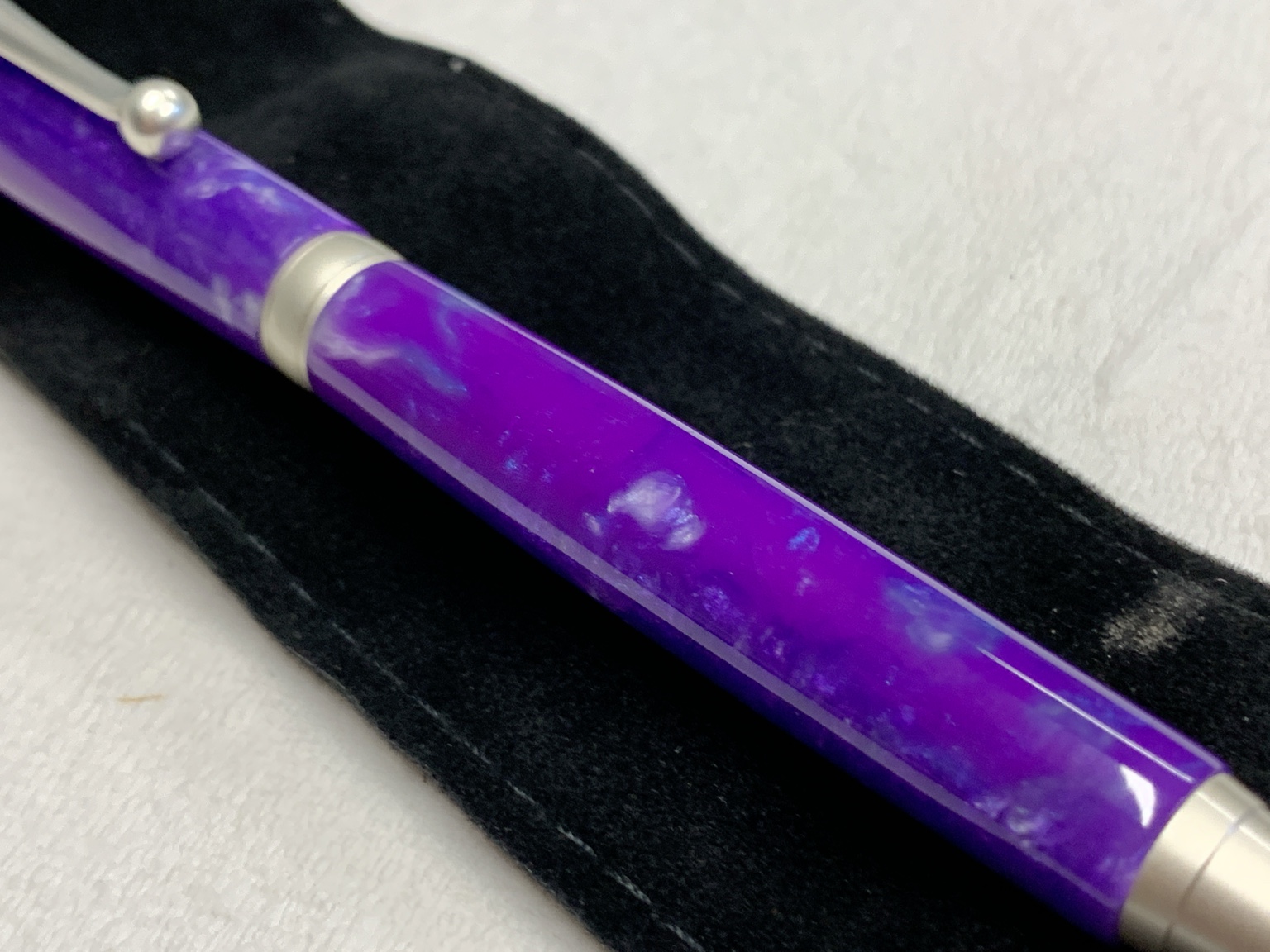

Poured a couple blanks for my wife. She said, "Just make me one of those normal pens. Something easy."
It's a gift for a friend. Alumilite Amazing Clear Cast with purples and pearly white highlights.
Standard setup... used my sanding jig to get the ends right on the barrel. Trimmers seem too abrasive and kind of a hassle for me.
A little difference was I followed Mal's comment of using the Novus system. I had some bad scratches through out the blank. I had ordered the products already, so I just let the pen sit and cure completely.
Good stuff!! Got the majority of the scratches if not all out! Small learning curve too!
Overall, calipers are our friends. A steady hand is good. I'm quite pleased with how this came out.
