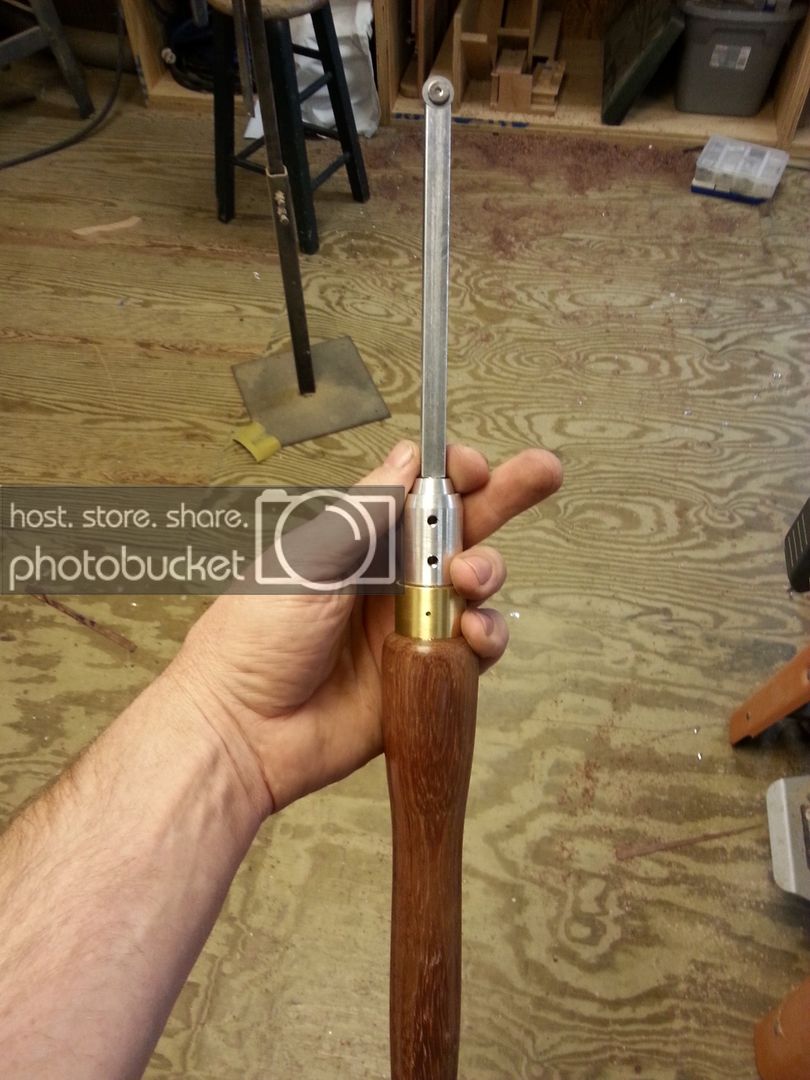

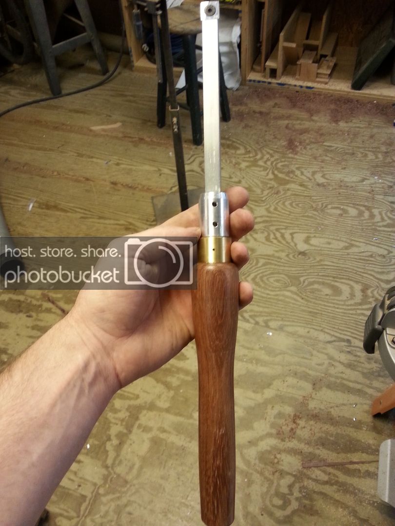

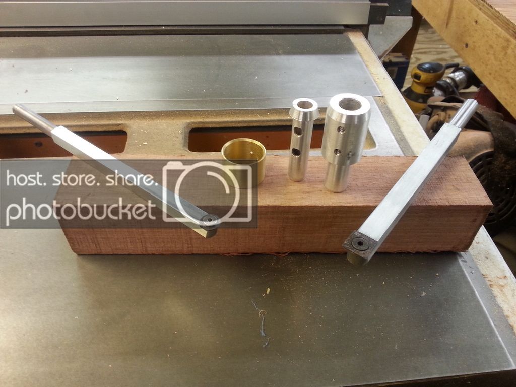

Been making carbide tools and thought lets try a interchangeable tool handle.
Purple heart, brass ferrule, Aluminum holder drilled 1/2" with a 3/8 adapter for the 12 mm round
15mm and 12mm carbide holders.

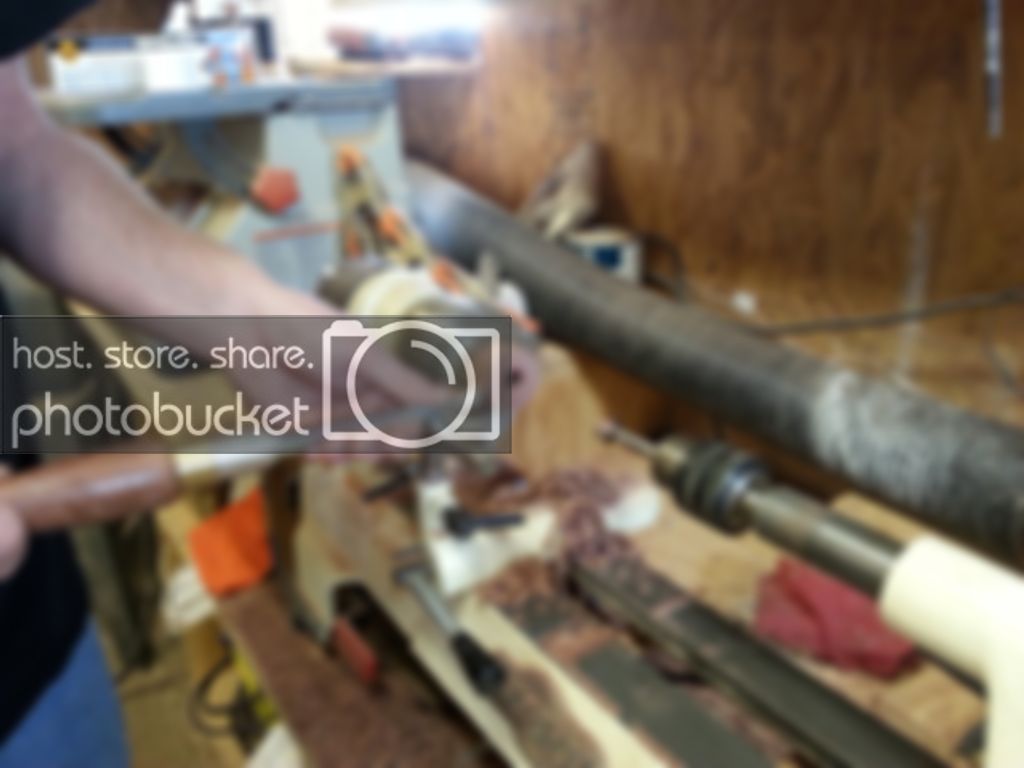

Photo taker didn't get any pics while turning from square to round.

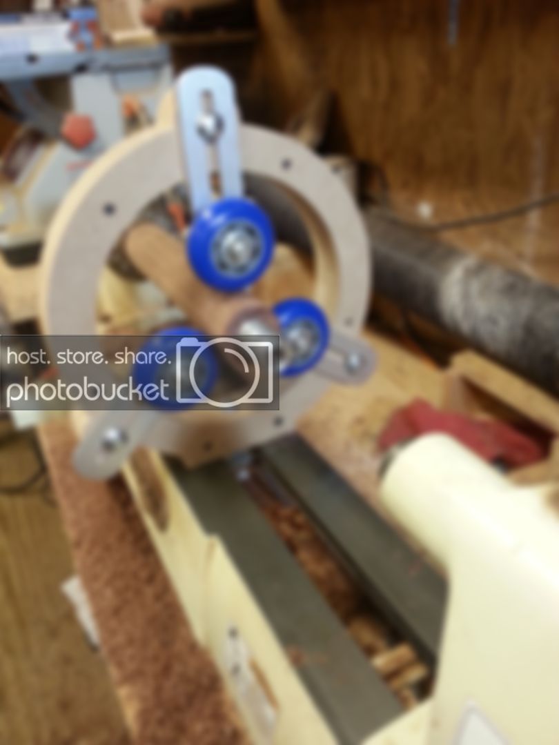

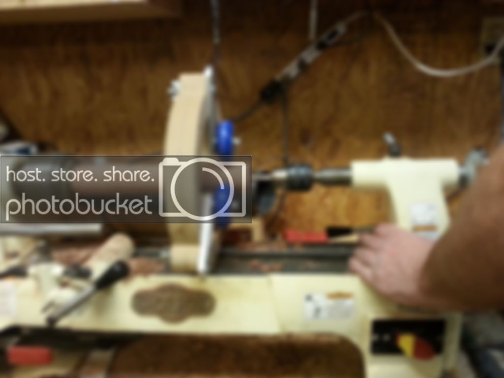

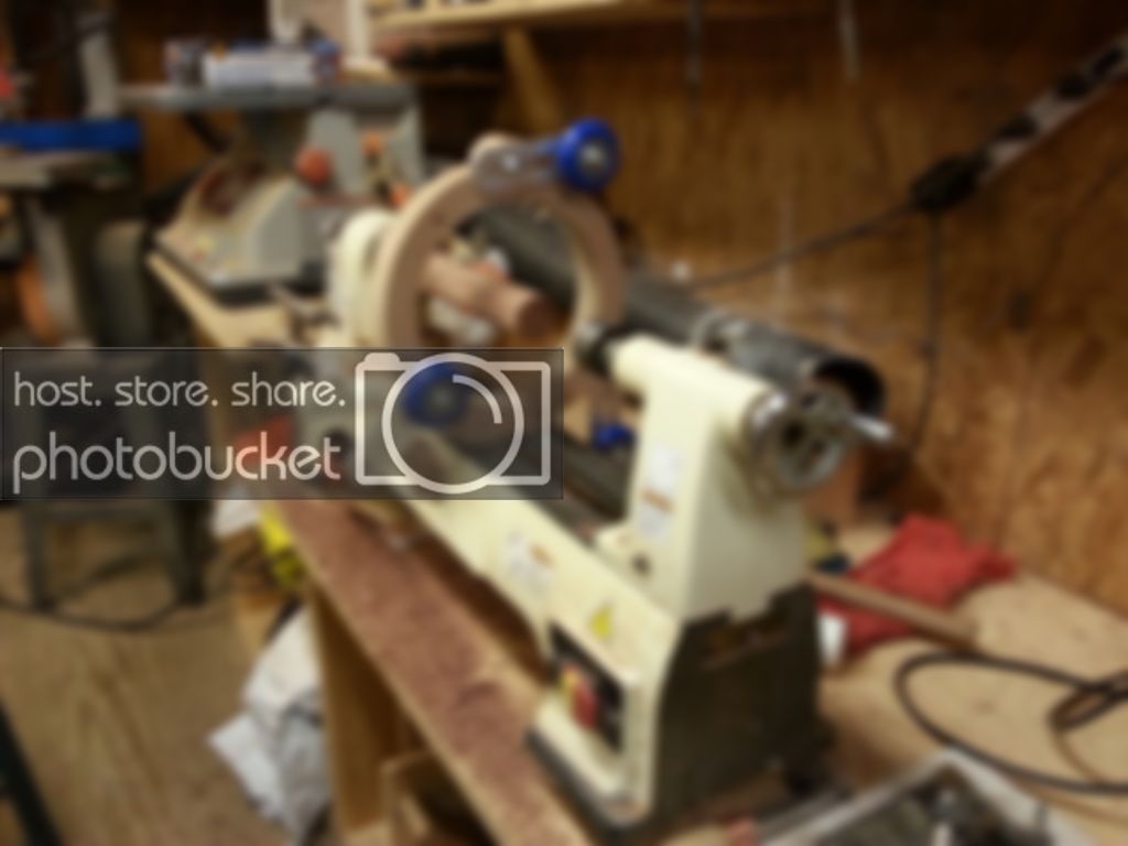

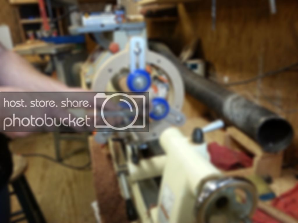

Setting up the steady rest I made.
Drilling 5/8 hole

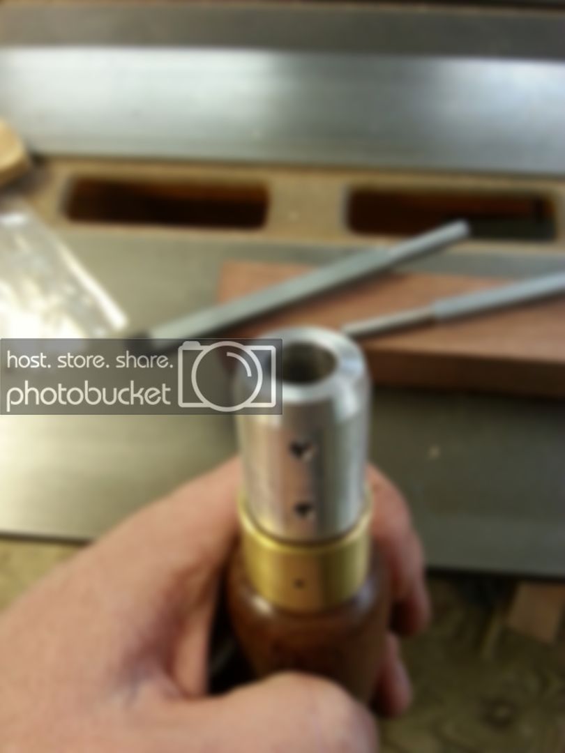

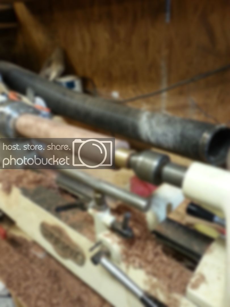

Turning shoulder down for the ferrule.
It fits also.

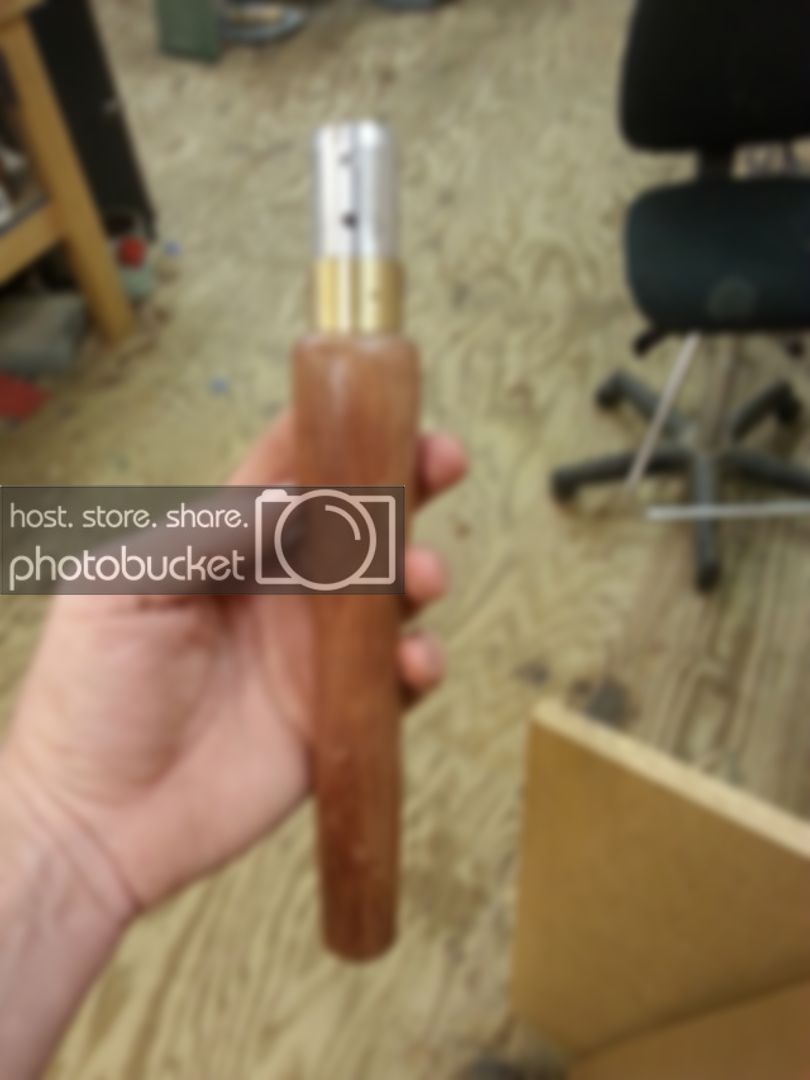

Test fit, Looks pretty good to me.
To be continued.... have to wait for finish and glue to dry.

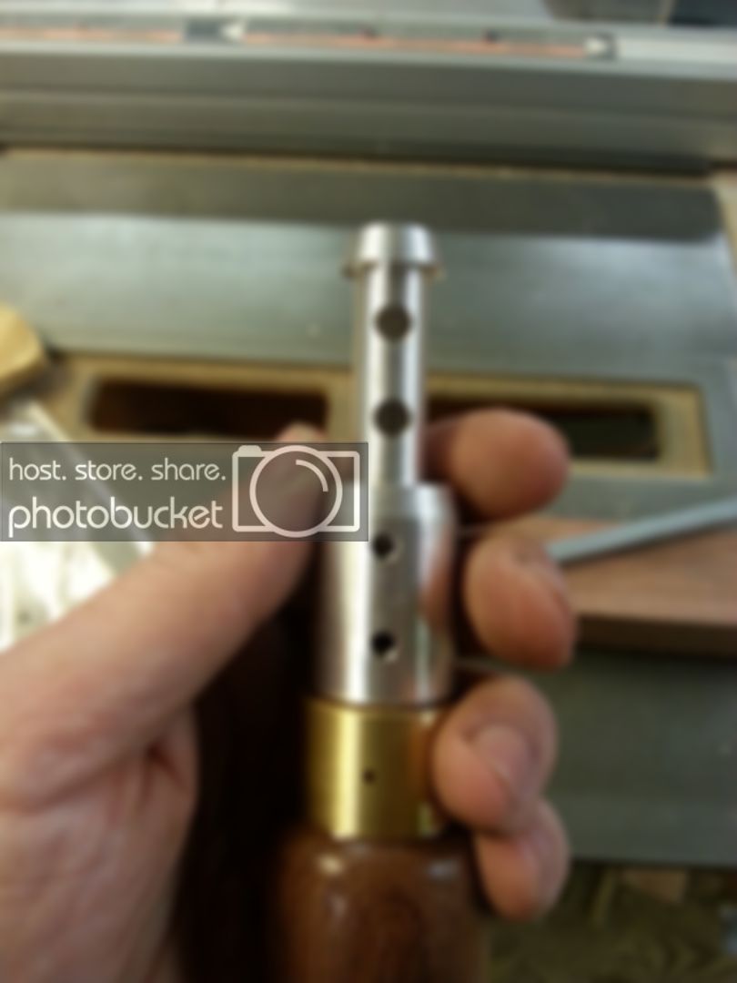

Learned a couple things while epoxying the parts together.
1- don't lose the brass tack for the ferrule
2- drill hole in bottom of aluminum before putting it in the wood. Need a way to let the air escape when pressing together.
3- don't use a lot of epoxy, it will come back in the air hole and won't let carbide holder 3/8 insert sit all the way in. But fixed by using 1/2" drill bit by hand cleaning the inside out of aluminum insert.
4- When buying the set screws pay attention to the the size. Grabbed 10-32 instead of 10-24.
15mm insert
1/2" hole
3/8 insert
12 mm round

Good looking tool handle... looks very neat and precise.
But also looks a little short for my tastes.. just me.
Also not so sure I would like interchangeable handles... Having to stop, unscrew the cutter, put in a new one, tighten the screw again would be a little off putting to me... again just me.
Agreed about the length - this is a comment - no intent of criticism - it's difficult to make a handle of any length without at least a 24-inch bed on the lathe. The chucks and the drill bit take up several inches of the length of the bed.
Like Chuck, I have never had a desire for an interchangeable handle but that doesn't take away from the fact that this is a great job and a good tutorial on how to do one.
Thanks all, With the interchangeable handle with having small lathes it can be difficult to turn a handle (for me). I could probably got 1-2" longer but that was the thickest and longest piece of stock I had.
Plus it was something I seen and wanted to try to make one.

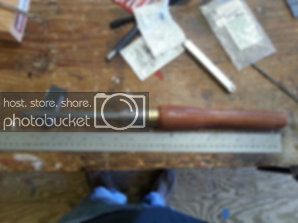

The handle is about 11" total with the 6" cutter it is almost 17"
