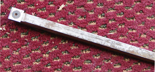

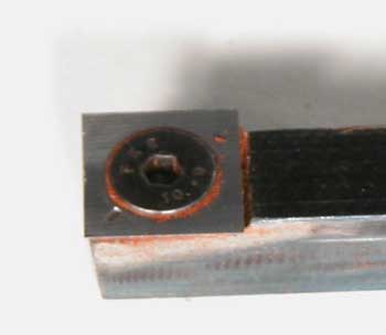

I made a couple of the tools like the skogger<sp> I used a 14mm planer insert, I have only been able to try it on my metal lathe,(not a recommended procedure) after I used my tool holder and put a 6 in piece of 3/8ths square stock to act as a tool rest which put the tool way above center, so I had to really angle the tool way down, (not the most Ideal situation) but good grief this thing removes Ipe like it was balsa wood, I sent one to another turner that has some real talent to see what a good turner could do with one.
I think I might try and sell a couple if they get a good report from this friend, I was surprised how quickly it went through the Ipe, I wish I had my wood lathe set up, the way I was using it it was throwing wood over my head at an alarming rate. I used some 7/16 square 4140 stock and that left about a 1/16th of the insert hanging off the edge on both sides and the tip of the tool, this ought to work well for making boxes or vessels with a square or flat bottom, I've wanted to make some lidded boxes for a while. I could have used 9/16 inch stock which would leave the cutter sides inside or flush with the side edge, I think I can find some inserts with a radius if I can I won't have to worry about sharpening tool any more.
Before any body get's their knickers in a twist, I'm not trying to sell any of these yet. If I do decide to I'll post them in the classifieds.
Added Pics
Here it is, I took this after making a paduk and pick gaurd slimline, I took it all the way down with the tool, The main reason for the tool is/was to cut multi material blanks, I'm going to foray into weird pretty soon, but it cut bot the Paduk and the pick guard with equal ease, you just can't lean on it, I don't even have a handle for mine, that might help but it eats wood so fast it's scary. I'll post a picture of the pen in SOYP

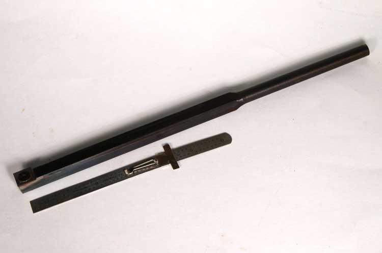

Very similar to the Ozark hogger I made and showed off in an earlier thread.
I bought the steel stock from a local steel fabricator.
The entire tool cost me about $5.00, nearly $100.00 LESS than the commercial brands.
And, yes, it removes wood like crazy. I strongly reccomend wearing full face protection because the chips it throws are like a snowstorm.
