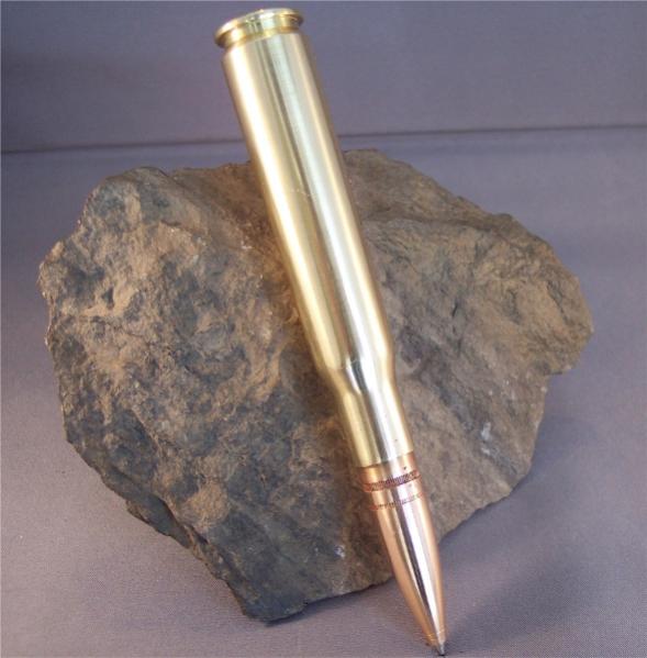

Hi all, I finally got to putting together the 50 cal. cartridge pen kits that I got from Daniel, thanks buddy! They make for very cool pens eh?:biggrin:

We need to get together so you can show me this one in person.
Absolutely, there's three of us, (along with Darrell Eisner 'scotian 12') we're pretty close to having our own Halifax chapter:eek::biggrin: Three bluenoser's together...nothing good can come from that:biggrin:
Nice job John, and glad to see they made it all the way up north without to much delay.
I actually have one of these standing next to my computer. it is what I use every day. it is a surprisingly good writer.

My kits are strictly cigar pen style. and I recently discovered a real good reason to do that. drilling a 7mm hole for the slim line tube would not remove all the lead from the bullet. I thought this out enough recently when working on some other types of bullets. so far the only bullet i have found that does a good lead free job is the tracer round with a cigar kit. Drilling a 7mm blind hole into lead is no picnic either. I don't think I'll be trying it again any time soon.
Great 50 Cal. Did you put the cross refill or the parker refill in it?:good:
