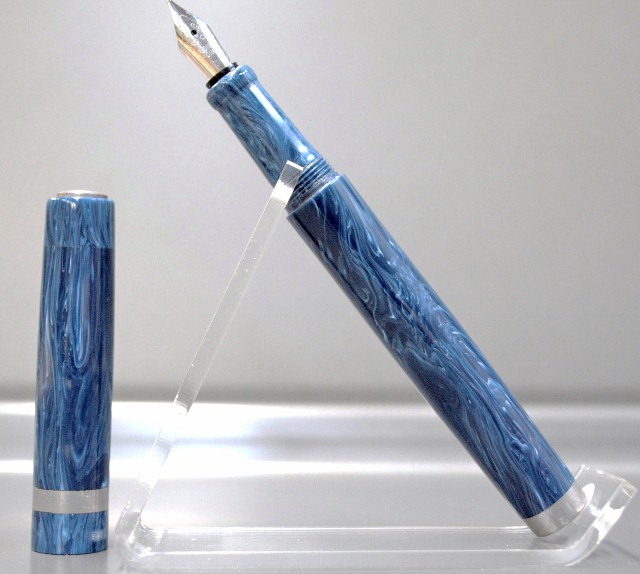

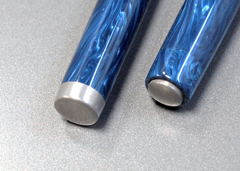

I just tried this two weeks ago. The bottom finial is threaded. I thought the M3 stuff turned pretty much like aluminite--very soft material. I understand the lava-based M3 is a different story.
I'm not up on all the M3 Available, but that pen looks like it is the Amedio Blue acrylic from Exotics, which is a standard acrylic (not sure exactly which one...)
[link]http://www.exoticblanks.com/index.php?page=shop.product_details&flypage=flypage.tpl&product_id=9413&category_id=32&option=com_virtuemart&Itemid=60[/link]
Yes, sure it's Amedeo, but the center band and finials are silver M3.
