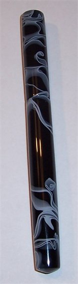

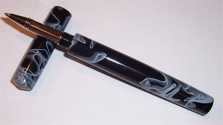

I got a little more adventureous with my second Baron. The material is phantom grey lucite and the kit is a chrome baron.
Comments and critiques are appreciated.

I decided to try to do this one tubeless. I tried using black nail polish to color the inside of the lucite and was not really happy with it so went back to using black rustoleum paint.
The blue black lucite I used before was not that transparent but this one is very transparent.

I used a BBQ skewer to get the paint in the lucite.
I do not have a fangar pin chuck though i hear excellent things about them. I have several pin chucks that a machineist made for me one of them fits in the baron body. The baron cap and the gentlemans body seems to be about the same ID so if you have a gents pin chuck it may work on the Baron cap. None of mine fit the cap which is a much larger hole and while I ordered 3 new pin chucks for some of my kits yesterday (includeing baron cap\gentlemans body)I did not have the patience to wait. Plus this is a tubeless pen and I modified the threaded insert so that the hole I used for the cap is signifigantly smaller than the normal Baron Cap hole (it was one of the letter sized drills can't remember which).
When I do not have a pin chuck I usually just make a jam chuck. I take a steel rod that is at least 1/8 smaller than the ID of the tube glue a piece of hardwood on it and turn the wood down to the tubes ID (internal diameter), if you go to far build it up with a couple coats of ca. It works very good for larger tubes. For this Baron cap I got lazy and I am suprised this worked as well as it did. I had a piece of drill rod that was just a hair to small for my hole( i think 3/8ths rod) I just put a couple wraps of teflon tape around it to get it to size for a jam chuck, it ran supriseingly true.

How does the pen feel in your hand, is the diffeenece in barrel diameter at the transion to the hardware greater than that of the kit standard?
It is definately a little bigger in the body than a standard baron, I did not measure exactly how much. Even with the mod I did on the cap I needed it a little bigger so the body and cap matched up. Also because it is tubeless I wanted to leave a little more meat on the pen. I think it feels pretty good in the hand but larger transitions usually do not bother me it must be the way I grip the pen or something. I did round the corners where the cap and body meet and I feal that helps with the transition.
