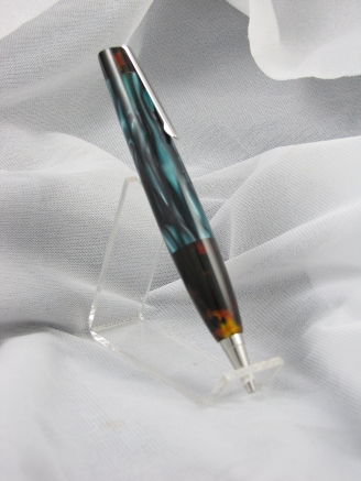

The slimline is a versatle pen and I liken it to Chess. Easy to learn but more complicated as you learn. A slimline pen can become anything but a slimline pen.
I too like the Sierra and wallstreet II kits and now they are coming out with different platings and making it a very upscale pen. But the slimline style almost demands expermentation and...it is cheaper.
