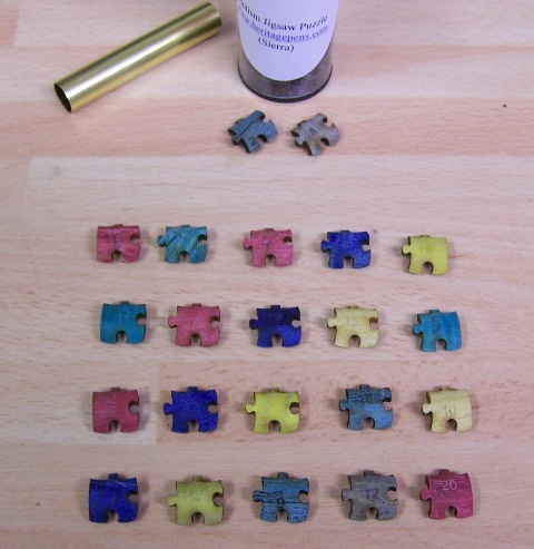

The first pic shows the parts laid out ready to stick on the tube. Arranged so that similar colours aren't next to each other. There are numbers on them, but I couldn't find any logical sequence.

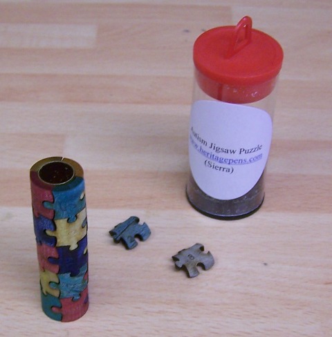

Second pic shows them dry assembled onto the tube.Here I hit the first tiny snag. The tube was proud of the assembly by a gnat's hair. No biggie,just sand it down a little.

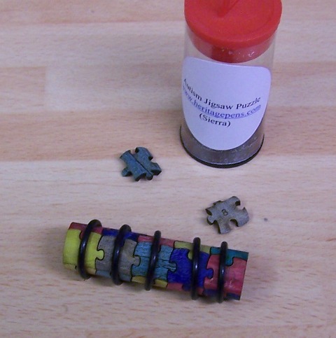

Like every other one I've seen, there were a few really tiny gaps between some of the bits. Also no biggie, just paint the tube. I expected this as if they were absolutely perfect, then you wouldn't be able to assemble it.

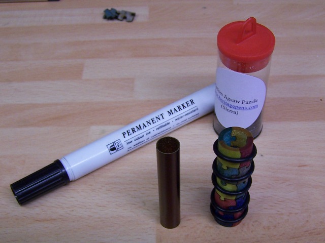

I then used a couple of rubber o-rings to squeeze the parts together around the diameter of each layer, then remove the tube and used a permenant marker to blacken the tube. Then just glued up the tube and stuck it in the assembly. As I'd already trimmed the tube, it was now possible to press the ends in so I had pressure from all sides of the parts.

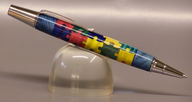

Whether it was done on a regular Sierra or not, I'm pretty pleased with the fit of the parts ( except one of my own thick glue lines :frown:)
They are fun little projects and of course, for a very worthy cause:biggrin:
