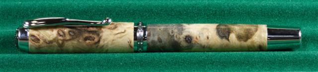

This was the first time I've turned stabilized buckeye burl. Man, this stuff had holes all over the place. I almost gave up on it when I started seeing the brass tube in several spots, but I stuck it out and it turned out pretty good. I sure used a lot of CA glue and wood chips/dust to fill the holes. Is this normal for it to have that many holes? Anyway, another Statesman Jr rollerball to add to my collection. :) Thanks for looking!

Hey R.T., this was a good chance to use those holes to an advantage. Add inlay material. Turquoise, lapis, abalone sea shell, etc. Check out Bill's and Craft Supply for ideas. I have used material from both. I almost look forward to voids in wood now. One of the neat things about Buckeye!. Use a small Dremel tool and a very fine bit to open up small holes. Kirk[8D] BTW your pen looks great. I do understand the hassel it is to do Buckeye. It's worth it though[:D]
Looks good RT. Lots of different colors and patterns. I have real good luck with stab buckeye burl. ussually hardly any voids and turns like a dream because of the stabilization. chalk it up to your good luck. Anthony
Thanks guys, well one nice thing about it, I was able to use up some of the left over saw dust for a change. [:D]
R.T.
R.T. Inlace is a good choise but just remember that a little goes a long way. A couple voids in the right place filled with inlace I believe adds a nice touch, but if you were to fill each hole than from my experence, it's too much. I did a stabilized Cotton Wood Burl that had a lot of holes and I used inlace in too many of them and it really took away from what would have been a beautiful pen.
And as far as having holes in stabilized wood blanks, there a couple of woods that usually has quite a few at least in the blanks that I've had. Like I said cotton wood burl is one, then there is elm burl and I've got some redwood burl that has holes but for some reason I have'nt seen any holy buckeye burl.

Wayne, I'll have to pick up some of that stuff and give it a try. Like you said, on this one I think it would have hurt the looks of it more then help it, just because of how many holes there were. Anyway, thanks for your tip!
R.T.
COFFEE!!! I have been using coffee to fill voids since hearing about it on another board. I usually grind it finer with a burnisher against the lathe bed. Then fill the void and saturate with thin CA.

Thanks Mike & Ken, I guess I made it sound like it was a lot harder then it was. More then anything, I was just shocked at how many holes there were. It took a little longer then normal, but to tell ya the truth it really wasn't that bad. So if you come across one like that, don't give up on it, you can do it if I can. [;)]
