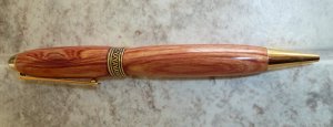

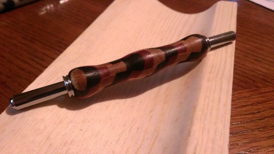

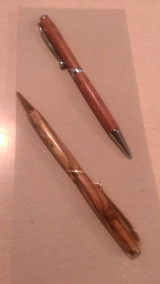

G'day Everybody and many thanks for your valued comments. Today I decided to try something new. I had bought this small can of PSI Gloss Sealer, Lacquer-based Friction Drying Polish. I did everything as usual before applying the finish. I have this lint-free cloth that has the feeling of felt-- sort of. Using just a 3"x4" patch, I put some sealer on it and coated the pen with the lathe off. I started the lathe and applied the patch to the pen and just watched the shine pop out--very similar to Mylands. I did this about 2-3 times and that's it. This was an experiment because I was concerned that the pen would have a thick coating and look like plastic. Very pleasantly surprised with the result the sealer gives though. I was going to post a pic but I only know how to do it by uploading from my pc and I don't see how to do that here. Anyway, looks like I'll be using PSI gloss sealer for my pens for awhile..
stan
OK, here's my first photo insert try:

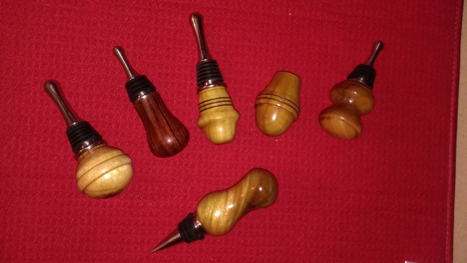

I started with a CA finish (still perfecting my process) and still use it but the fumes make me sneeze. I ordered Drs Woodshop pens plus. I knew from other articles that this was not a high gloss finish equivalent to CA but I gave it a try. I have used this process on both bottle stoppers and pens and am very happy. A great feel with a medium gloss finish. I find sanding with the walnut oil very helpful for dry and porus / soft wood. I have heard that the shelaq holds up well.
