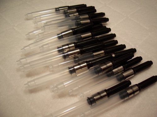

I have a handful of new Schmidt converters that were supplied with Craft Supply Gents, Statesmen, Emperor, and the Junior sizes of all three models.
I found that out of this handful of converters, all fit very snugly in the large nib holders (Statesman, Gent, Emperor).
I also found that all but two fit very snugly in the medium nib holders (Junior sizes).
My (unscientific) conclusion is that there is the rare chance that a supplied converter might fit a little loose in a junior size pen and I would call Craft Supply and ask for a replacement converter.
The two loose converters were tried on several Junior size nib holders and were loose on all, so I suspect the fault is with the converter tip itself.

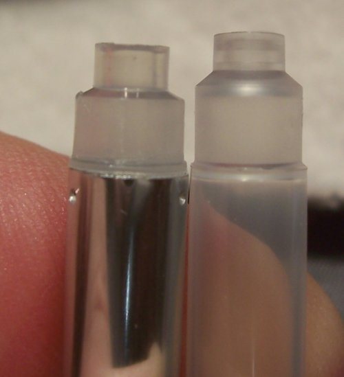

The pump type converter was mentioned so I checked them to the same nib holders and found that again, they all fit snugly in the large nib holder but didn't fit that well on any of the junior sizes. They all fit the junior size holders but just barely clicked into place. A close up look at the two converters side by side shows why they just barely snap in place. The squeeze converter has a metal body that keeps the converter from sliding further into the nib holder.
