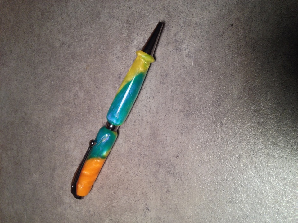

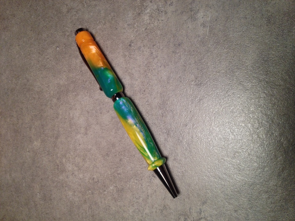

Hello all!
I am new to pen turning, only have a few dozen pens under my belt. I was hoping to get some feedback on a pen I just finished. I have been playing with the PR pens. I find them to be fun (for time being) I started out with wood and became frustrated. I think it is because of the wood I was turning, it was very old and brittle. Anyways, some feedback would be appreciated. Anyone who does PR pens, do you put CA on you pens?? Thanks-a-Million!

Very nice.. a lot of detail for someone new to turning. I am also fairly new, and do a lot of PR. I do not put a finish on PR. I sand with MM to 12000 and then polish with plastic polish and have liked that finish. I have used CA with PR to fix things and it works well, but really I have found PR to not need it
I got discouraged with wood for a while and I think it had to do with the tools I was using. I was not using SHARP enough tools. I have since started using a skew and in all honesty, it has saved 2/3 of my time. I used to have to sand through all the grits to get a decent finish, but now, with the skew, I can do some touch up with 400 or 600 and apply the finish.
Keep up the good work. I am not a big fan of the slimlines with the narrow center and rarely use them anymore. If I use a slimline I either make my own center band or change it somehow as I like smoother lines. But I do really like the details on yours. NICE!

Good looking pen! You did a good job finishing while keeping the cut edges sharp. With the wood you were turning have you tried stabilizing it with some thin Ca or epoxy? Just a thought.

Very nice pens for just getting started, Mike.
Great advice in all the above posts & I second the comfort center bands for slimlines. I make a lot of slimlines and only use the standard centerbands when I make a straight profile or one with just slight shaping. I use a comfort centerband or make my own when I want to leave more meat on the barrels.

I've never been a fan of the "stuffed sausage" look on slim lines. I prefer smooth slight arcing curves to define the top and bottom section. Also not a fan of the bead at the nib. If I did much writing with the pen, I think that bead would put a sore spot on a finger or two. Nice colors, nice craftsmanship.
