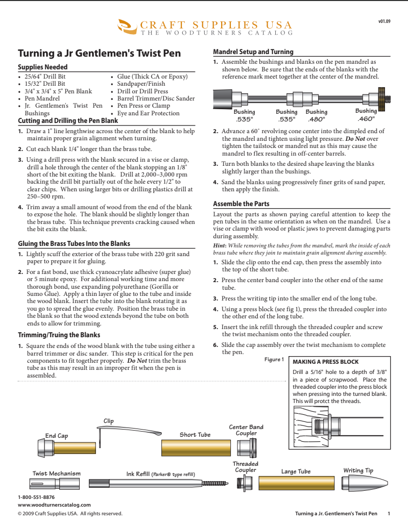

Hi. I have a couple NOS kits for a Jr. gentleman's ball point pen and pencil that I bought years ago. I am in the process of building these kits now and find that I have no instructions. I have some questions about assembly. If anyone has a set of these instructions that you could scan in and send me I would be very grateful. Especially if someone has instructions for the pencil as the two kits are slightly different in tube length and other things.
Many thanks!!

What does NOS stand for , who it it ? As all current Jr Gentleman kit instructions are easy to to find from vendors web site.

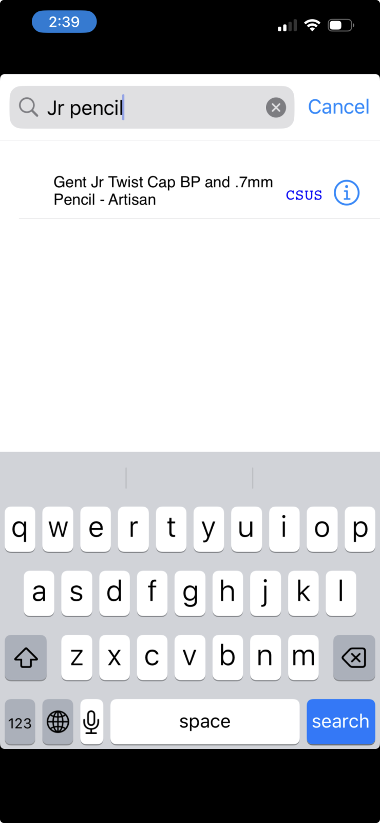

NOS is "New Old Stock" - means the kits are unused but no longer available. I have looked on all former providers of this kit and cannot find the instructions. I'll try to check the Android bushing app.
