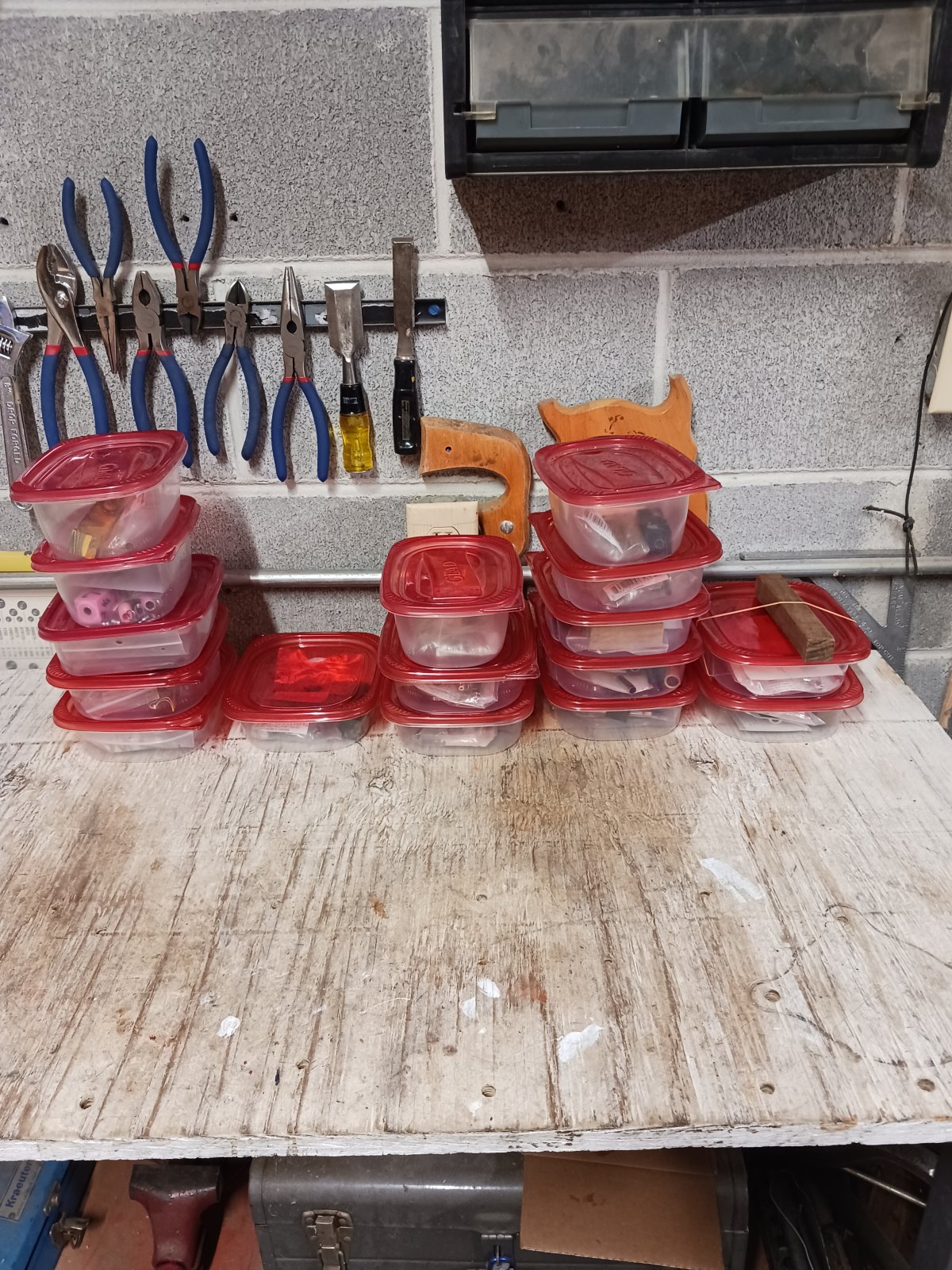

Pen making: I separate each kit and store in lunch meat containers. I also include a note of the material or wood blank, size drill bit and tube size.
