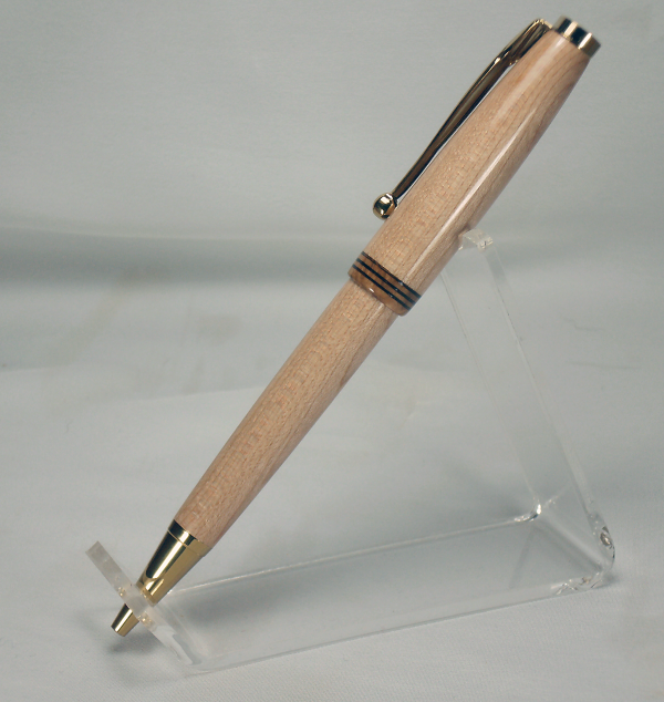

I've got 11 going out Monday Mack, I used the CB on the 3 in walnut for the contrast but the maple blanks I got from our friend are going out without CB. I used up some of the little pieces of burl that I had laying around and attached them so the pens resemble the 7mm euro like this one. Turned the bottom of the cap to roughly .5" and the top of the barrel to .4". Also cut the cap so the barrel slides about 1/16" inside it. I'ts actually easier you don't have to match any bushings.

Cigars look good in it as well Mack. I did one in black ti for this batch and will likely do a few more for the next batch, I've got nine more of the maple blanks for the next batch. Ed4copies came up with an offer on ti gold slims at a price I couldn't pass up providing they went to servicemen. This will be the first half of what I bought.

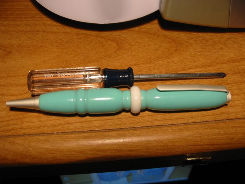

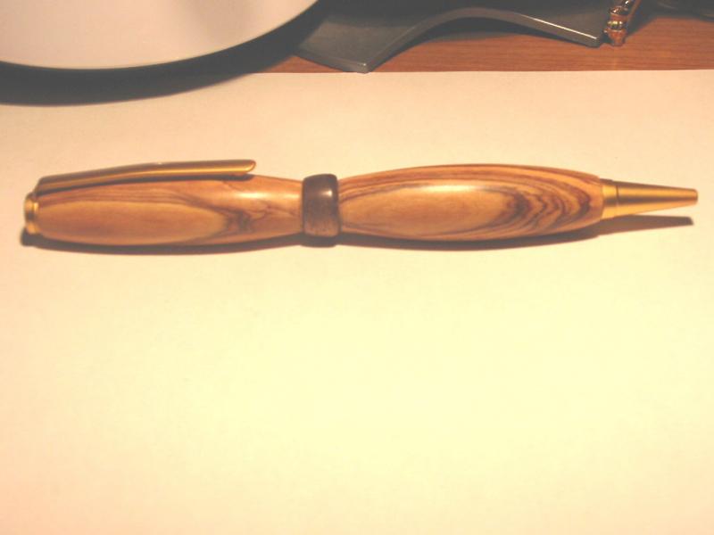

I make a lot of my own center bands on slimlines. You only have to drill a .25" hole in the piece of wood or acrylic of your choice and once you are nearing the final diameter of the two end blanks then you remove the middle bushing and replace it with the center band blank. Turn it to what ever shape you like and there you have it.

Hi David; I am aware of that, and it may be an alternative I'll try as well! Thanks.
