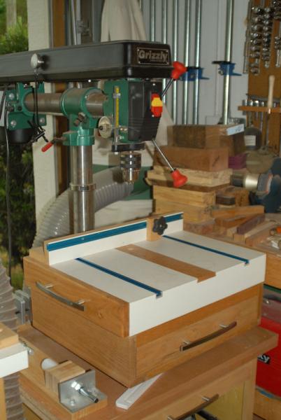

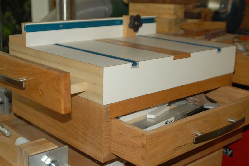

Here are a couple shots of my drill press table. The drawer below the table is really handy. The side outfeeds are rarely used. I did lose some height due to the thickness of the drawer/table but have not found it to be a problem yet. I'm sure one day a project will come along where it is an issue. If you have a floor mounted drill press then this wouldn't be a problem. The sacrificial insert is a sliding dovetail and can be pulled out and flipped around or replaced when chewed up.

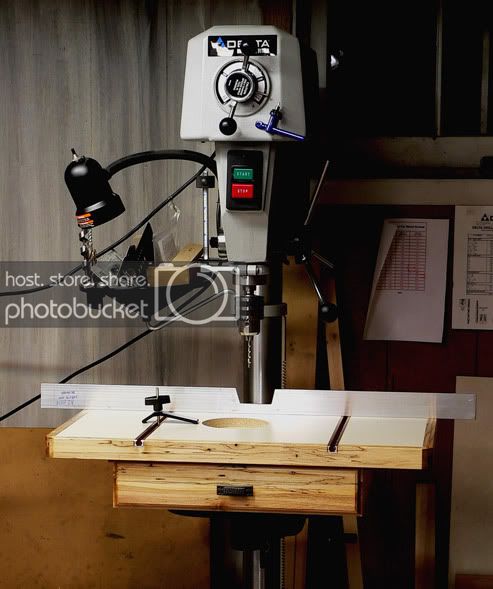

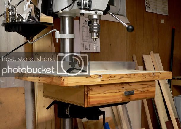

Here is mine, I found the plans for it on the Woodnet forum. If I was to do it again, I'd make the T-tracks closer together, to get the hold downs closer to the bit. The round replaceable insert is the best feature. The fence is locked in place by cam lock mechanisms using the T-track.
