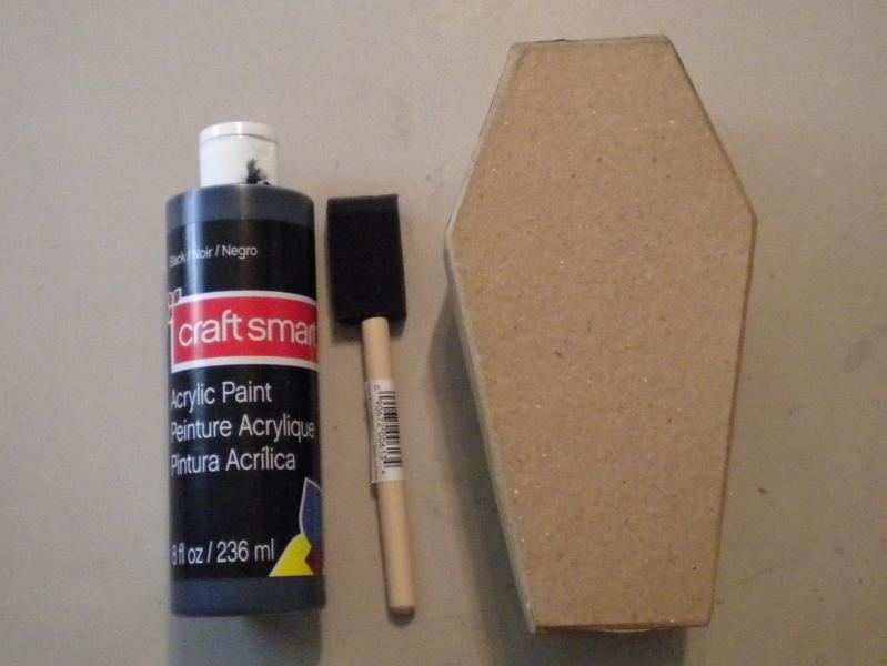

Here are some coffin boxes from Micheals.. I don't know if it will hold a pen though.
