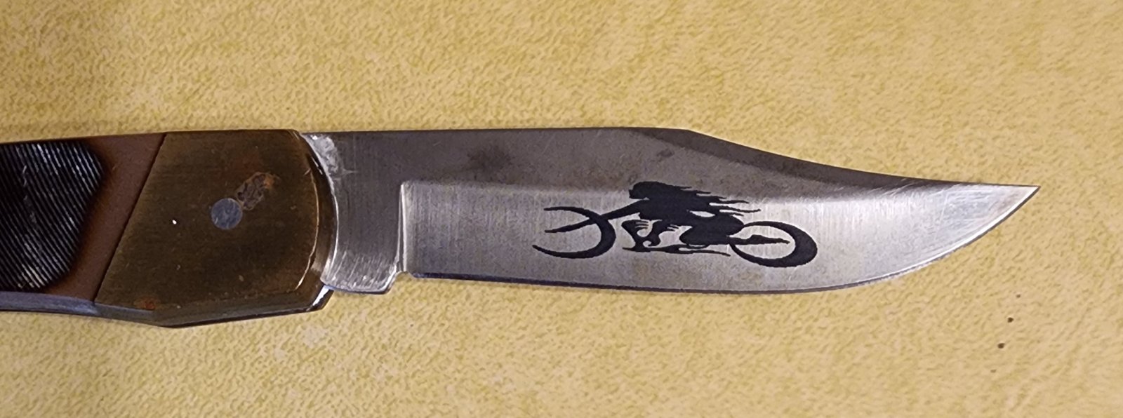

I got a very nice used Ortur LM2 S2 Pro 10w laser off facebook about a month ago. To engrave metal, they say at least a 10w laser is needed. Mine is a diode laser. I have a little 3.5w laser but it's pretty limited. I wanted something to engrave on knife blades. Here's a test I did on stainless the other day.
I did forget to add. It really isn't engraving on steel. You use a laser spray and it actually burns the image on.
