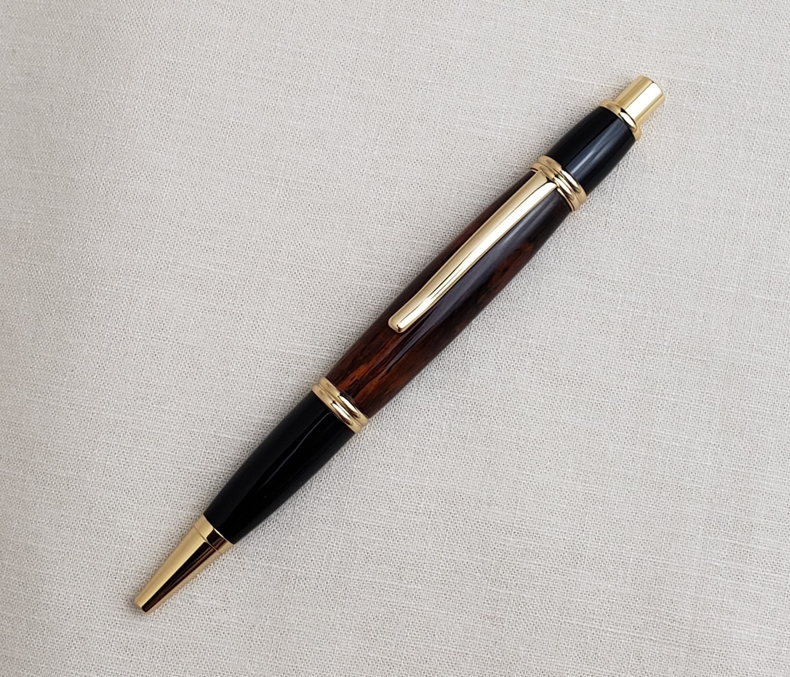

Here's a gatsby click I did a while back. It has a little less of a utilitarian appearance.
