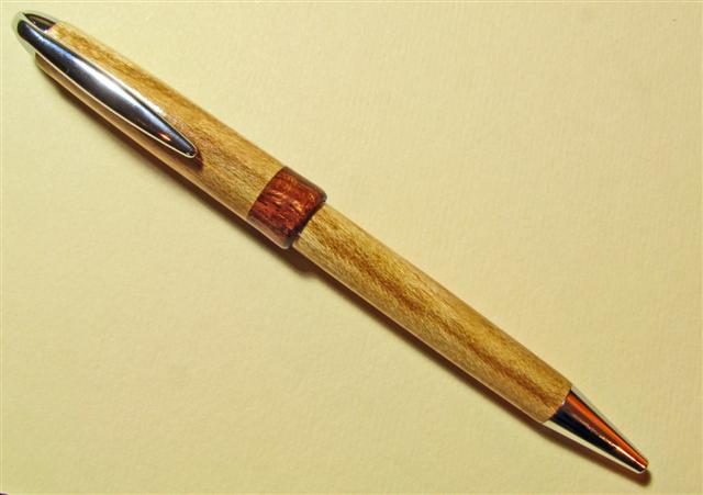

Hi Andy, Grant & John T.; Let's see if I can explain clearly, so that you might understand what I'm attempting to do!
I'm turning some Pens for Canadian Peacekeepers using the 7mm Streamline kit, which has a centreband (that I don't want to use on all of the pens) of approx. 11.4 mm in dia. So the dia. of the nib portion when turned using the centreband would be in the range of that dia. measurement. (say 10.5mm)
I want to drill a flat-bottomed hole in the cap part so the nib portion would fit inside so the design would look similar to a 7mm round top. (pic att'd)
attachment.php
I may be thinking too much inside the box (if you get my meaning). I just had a thought that if I drilled the proper size hole I require, I would get away with having to undercut the clip end and screwing up.
I have both 10 mm & 11 mm forstners, so I guess I'll stick with one of them. The 10.5 mm bit is not that crucial to my design. I'm certain I'll waste more time trying to find a bit that size than what it's really worth!

Mac:
Either a 13/32 or a 27/64 (both easily available) should meet you needs. Simply make the nib portion slightly smaller than the bit you choose.
The beauty of a pen set that "flares" to the center is that it can easily be modified to your exact specifications. I doubt that you could feel the "size difference" of the nib barrel between 10.5 mm and 27/64 or 13/32.
It might be easier to adjust the nib barrel than to buy a specialty bit? Respectfully submitted.

Thanks Andy; It shows you how I just couldn't get out of the box!
Mack, if you know anyone who has a metal lathe I'm sure that they could turn an 11mm forstner bit down to 10.5mm without damaging the bits drilling capability. Doing that brings you right back into the "thinking box".
Hi Glen; Another good idea!
Just so everyone who took the time to comment is in on my sol'n; I had decided to go with an 11mm forstner (thought I had one, couldn't find it), but I have a 7/16" forstner which is so close in dia. to 11 mm, I have decided on that.
My problem is solved, and as the saying goes "many heads make light work" or something like that! Thanks everyone!:smile-big:
