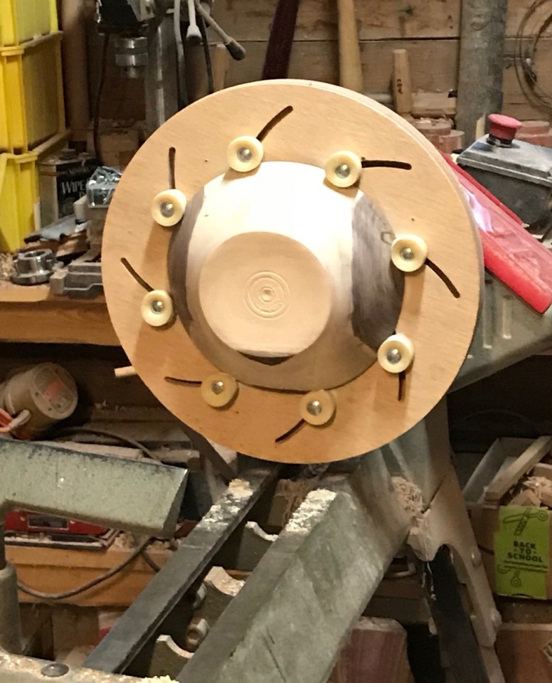

I have been procrastinating for a while in making myself a Longworth chuck. I finally got around to it today. I need to drill some finger holes and smooth it up a little but it works.
Relied on this link:
How To Make A Longworth Chuck - Ravenview
Great work ! . Is it really necessary to make the adjustment slots curved, or could they be straight and along a radius ? . Probably a silly question once I get the answer !!!

Nice chuck... just be careful with it as their hold is (In my opinion) less secure than a cole jaw set up. I made a Longworth a couple of years back and used it extensively, but always felt a little less secure... last time I used it, a 10" bowl came loose and careemed of my face....my error was not having a face shield on, but at 450 was just sanding and wanted nick a lttle bump off the bottom... evidently the scraper caught the bump and threw the bowl at me. I sported a black eye for a month.
I prefer a vacuum set up now or my cole jaw extensions with the head stock turned 45 degrees.
I made a Longworth when I was in Japan and found out fairly quick that my slowest speed of 650 RPM was a tad too fast. I used it once on an 11 inch bowl. It did OK but I was just scared that it would blow out or release. I used some quality 12mm ply to make it. It sure looked good.
