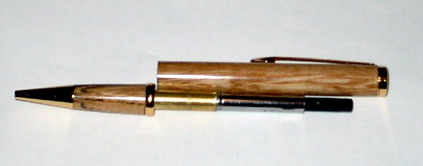

Here is a pic of my longwood:
Hope this helps
Ryan
Ryan is correct on how the parts go together. I was a little concerned myself George when I put together my first longwood. I made mine out of a corn cob, so maybe I should call it a longcob. Nice looking pen Ryan. Alan

Thanks Alan. What you can't tell from the pic is how I had to modify the pen to get it to work. When the directions call for the upper blank to be 3", they mean 3"(and that is after the squaring and trimming to tube length). I was just a hair sort and when I assembled it the pen would not go completly together. SO I removed the transmision, shortened the short tube on the upper side of the lower blank, reinserted the transmision, being careful not to go too far now (note, you can see the "line" on the transmision where it is supposed to be inserted to), then the pen went together as it should.
Ryan
