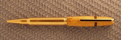

In making 30-06 pens it would be nice to have some longer transmissions. Anybody know where to find them, or have a trick to getting some extra length in that area? Is there a particular brand that is any longer?

I would like for the tranny to extend farther into the upper part of the pen. The ones I have made look and work fine, but the top is held only by a 1/2 inch or so of the trans. Just had a thought! If the refill was longer then the tranny would not need to pressed into the shell as far. Anyone have longer refills? A shorter nib would do the same thing. The ones I made with real bullets for nibs are fine.
My tranny is pressed normally and has full length into top section.
I merely used a longer tube, to go from nib to drilled out primer cup.
My tube came from an old kit from CS that had one longer than standard and a standard length tube.
