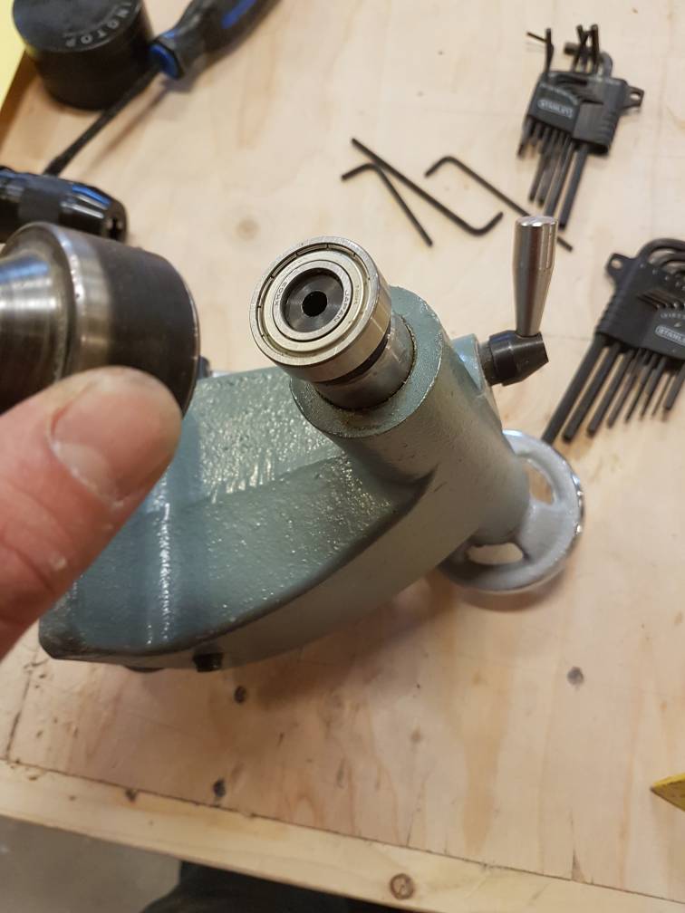

I've been trying to remove my live center to install my new drill chuck for 30 minutes now and there must be something I don't get.
I can,t pull the livestock any further (picture)

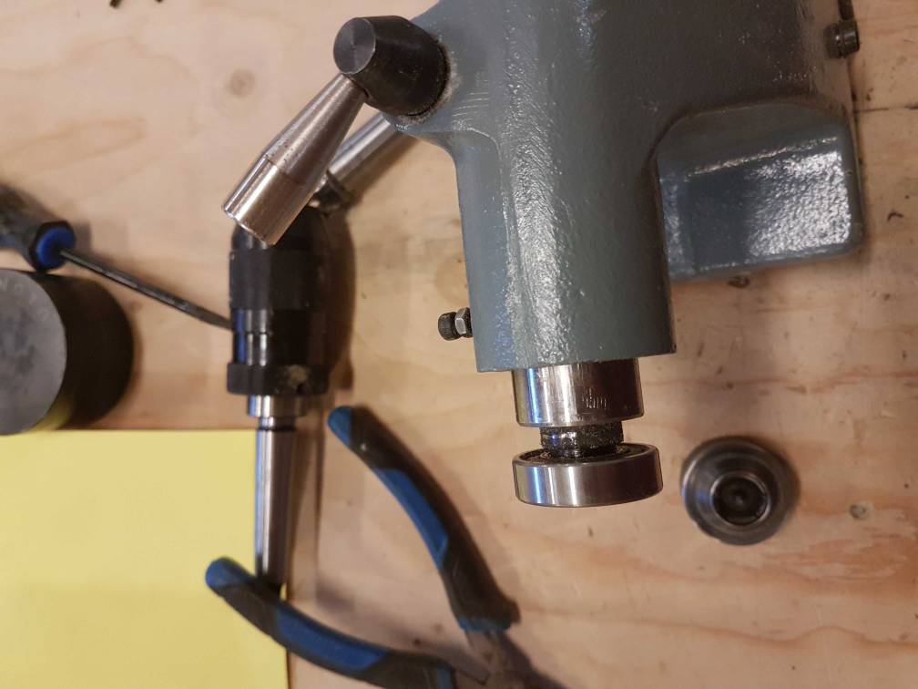

And I popped off the cap from the bearing while trying really hard to pull it. Can it be pressed back on?
Please help I finally have ecerything to get started and my lathe don't want to cooperate
Sent from my SM-G930W8 using Tapatalk
I'll take a stab- did you try to use the knock out hole from the back through the knob? And yes, normally you can press the front of the live center back on. Of course, you could change the bearing now if it is noisy.

Thanks you everyone.
Problem solved by my machinist friend on phone.
He said to turn the wheel.
I said the wheel was at max
He said TURN THE WHEEL STRONGER
Pop!!!
[emoji16] just got to change my bearing now since it make a clik sound my the dumb strenght I applied to it
Clean out the inside of the tail stock to remove any burrs and dirt that have built up over time. Make sure that the outside of your live bearing also has no burrs .
