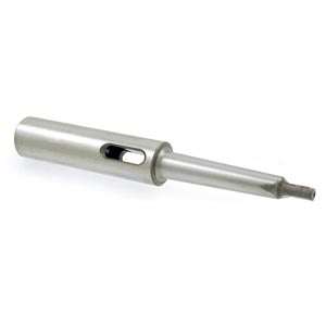

Is there such a thing available? It seems the bearing housing on my LC is too bulky to get the tool close to my turning stock. Maybe a low profile LC? Any help here?
Like this?
http://www.wttool.com/index/page/product/product_id/37144/category_id/14172/product_name/Standard+Drill+Sockets+%28Jacobs%29
or a Slimline Live Center like this?
http://www.packardwoodworks.com/Mer...Code=packard&Category_Code=lathes-acc-rtc-src
OOPS ---- I didn't realize in was in the metal lathe forum........ these may not apply!
Chuck,The only thing that has a profile that will allow you to get in closer is a CNC live center, , they have a step down at the point, so you can get closer in, The drawback is even Enco get's at least 250.00 for them, try Feebay, here is an MT-3 but they are around from Enco in an MT2, http://www.ebay.com/itm/Royal-MT-3-...7992231?pt=LH_DefaultDomain_0&hash=item484064. Royal make a very good tool. but unfortunately I've never seen the CNC type centers cheap.
