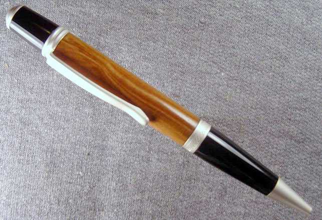

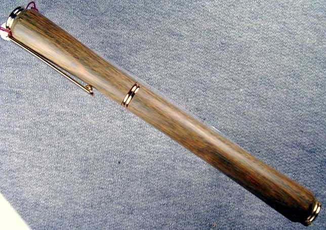

Oh, and John, how's this?
<b>Image Insert:</b><br />
<br />
<br />
Originally posted by alamocdc
<br />Frank, the LV I have is varigated so I don't find it featureless at all.[;)]
Yes. Lignum vitae has a very tightly interlocked grain, which not only makes it very strong, but can give it an almost feathered appearance. Many pieces also contain lightly contrasting colors - i.e. nice striping.
And (now I'm not critisizing your pens in any way), that's not even premium LV. Most of the lignum vitae I've seen is just as pretty as the piece in your sierra.
You are correct, Eric. The first pen actually has better grain than is showing, but the photo quality and position of the pen hide that. It is not as nice as the Sierra, though, and most of my LV is even better than that.
