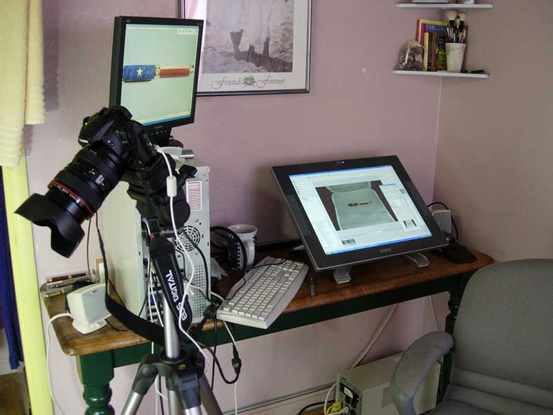

I just wish I could see a live picture on my PC and just keep fiddling with the camera till the picture on screen looks good, then take the shot. I would be the first in the queue if a decent camera for dummies was ever sold.
Queue up Skiprat!
Computer controlled digital photography:
Camera under computer control, hands off operation.

Well done Kiddo, I knew YOU could do it. Now spill the beans matey!!!
How did you do it? [:D]
Oh, one thing though....I realize that you aren't technically inclined, like the rest of us photo gurus but you can get more use from your pc if you turn it around[}:)]
Again, well done. Can't wait to see how you did it and if I can make it work on my camera

Originally posted by skiprat
<br />
I think you said you have the 350D model. Just load the CDs that came with it and plug it in. :)
By the way... is that a blond joke?
[:I]
Actually, there are no controls on the front. Everything I seem to use most is on the back of the pc. Even the CD-ROM is mounted elsewhere.
