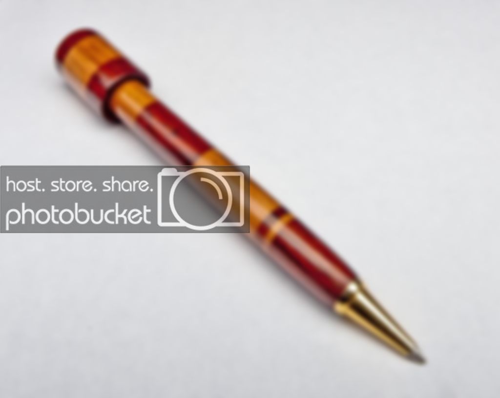

These are my first photo's using cross polarization,
I was using one Alien Bee's /1600 strobe with a Paul Buff 10 x 36 soft box,
I had the AB/1600 turned up to 1400watts.
I photographed this tethered with my Canon 5d mk 2 with a TSE 17 mm 1.3 L lens. with a Fotodiox 145mm CPL .
My lens was less then 6 inches from the subject. F22 1/325 shutter speeds. iso 160.
This is also the first pen I made. I used a a couple of parts from old pens.
IMO the cross polarization on pens works well.
It does one hell of a job getting rid of un wanted glare or reflection
