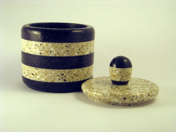

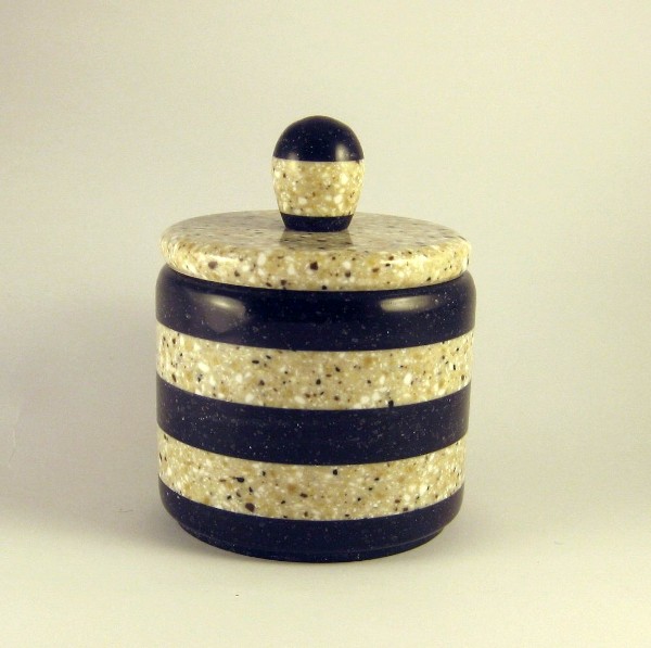

I made this lidded box for a demo I am doing for my local turning chapter on sunday. I cut the layers into circles on my band saw, then the center circles on my scroll saw to make rings. I then glued them up and turned them. The lid finial is made from the inner circle scraps.
