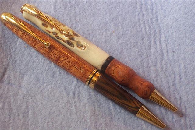

Pictured below are two "long-woods" made from relatively inexpensive "kits" or as the pros say findings(I use the word components
The top is a "fancy"slimline in a gold kit but other platings are available.
The bottom pen is a "PKMONPAR" Euro style with a custom clip, still under $5.00.
What is it that gives value to the pen you are giving?
Your work or the platings?The woods or the platings?
Your ideas or the design by a mfgr that is sold by the 100,000's to pen makers?
The design of the Euro Style is pretty traditional.
Are you showing off the wood or the kit?
<br />
