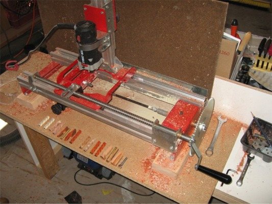

I made a new work bench for it. This side of the table is for the Legacy and the other side of the table is my new pen assembly area and other stuff, about 4x6
This is the Legacy 200

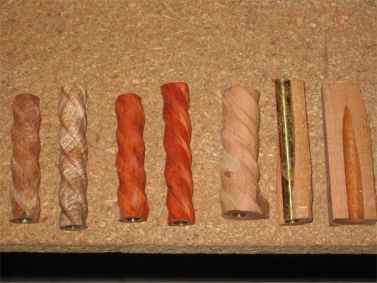

I had a bunch of slimline blanks allready glued up from years ago, I don't make many slim lines, so I finally found a use for these.
Here is my first try from R-L

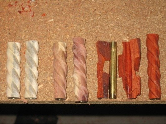

Ouch ! [B)] I just hate flying debri in my shop ! As soon as the bit made contact it went flying. I had the trimmer up high just to get the feel of the first cut, Boy did I get the feel, a ricochete off the body. 2. The Pauduk was not bad, but the cap had a slighty different twist than the bottom, 3. the silvertree was even better, but the cap twisted and spun on the mandrell and it made a mark on the top cap. These have just been cut, right off the mill with no sanding.
Test bacth two, R-L another pauduk, more flying debri [B)] juniper was not bad and the last one I think is buckeye burl came out the best.
So far my summary is, soft woods are definately better to make spirals out of. The instructions are week on how to use the machine. They make no reference to what type of bits to use. I used the ones Scott sent me, a photo is shown of the bit. You really have to tighten the blanks in the mandrell from keeping them from spinning. It tskes three passes to cut the spirals. I am going to call Legacy and see what bits the recomend.

It looks like there's some good potential there. The buckey burl and silvertree do look pretty good. It will be a real project to sand them correctly and get the pen parts to flow well. I can't wait to see what you come up with.

Those would make some cool longwood pens with a transition hand cut spiral down to a traditional nib end. I may have to ask you for some contract work.[:D] Have fun with your new tow.

Are your mandrels by any chance all Berea? Berea uses mandrels with 1/4-20 (1/4 NC) thread. All others I've encountered (which I'm sure is not exhaustive) use 1/4-28 (1/4 NF). These Legacy guys do not make mandrels - they use CSU mandrel shafts. At least they did when I saw the machine demoed. Don't forget - they know very little about pens!
Are you cutting from square blanks? They probably tell you to in the instructions. I have a feeling you will be happier if you do use hard woods, but turn cylinders first. The diameter of the cylinder needs to be just a little larger than the high point on the profile you're making. I tried 1 on my mill lathe with from a square blank, and while it worked, I was really worried about chipping especially at the ends. You're hogging quite a bit of stock there
Don mentioned core-box bits. Those make sort of the inverse profile from yours. You can get a couple of core-box bits from MLCS for very little, definitely get 1/4" and 3/8" and see if you like the result. The larger the diameter the flatter the spirals, of course.

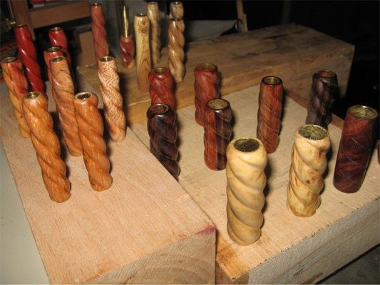

Okay...GOOOO....todays labor..... 7 slim lines, 3 Barons, 2 Gents, cut, sanded and first 3 coats of Deft.
So what do you have to show me ? [:D] [}:)] [:D]
Your right Rich, no more blow outs. I turned them round on the lathe, then went to the mill, worked much better.

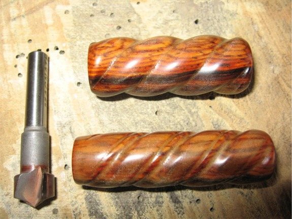

Here is a different twist on things.....I took the regular rope bit( now that I know what bit I really have [:D] ) cut the Baron cap like a regular rope on center. For the bottom, I cut a regular rope, went to the lathe and flaten the rope, went back to the mill and recut the rope using a different pitch, back to the lathe and knocked it down again to get this effect.

<br />went back to the mill and recut the rope using a different pitch,
Well, not a different pitch since that's fixed [;)] But it's an interesting effect. I think you will soon feel the restrictions of this tool as you you keep experimenting and start running into the limits. Then come the ideas of how to modixy the tool to let it do more [:)]

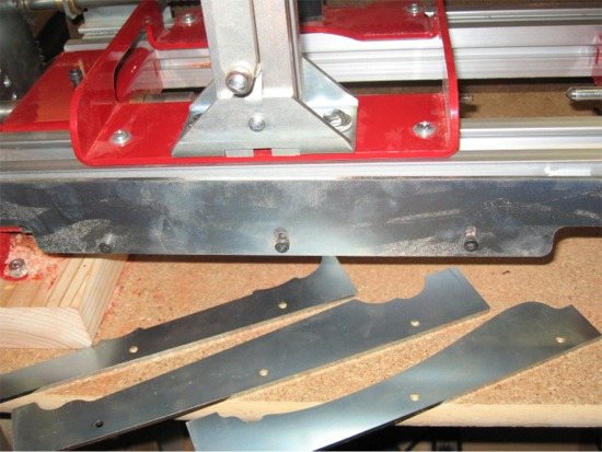

Here are some close up pics of the features on the machine.

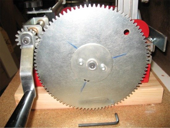

Indexing is done by loosing the nut and rotating the index plate.
As you turn the crank handle, it rotates the stock and moves the router down the Y axis. Mine has 12 positions for indexing, the manual says 24 ? I noticed I am missing the turning knob, no wonder it was hard on my fingers to index.
<br />
There are templates allready made for various things, To cut a taper, you have to angle the flat template, or you can make your own templates for the machine out of MDF. The roller bearing will let the router follow your template for the Z axis

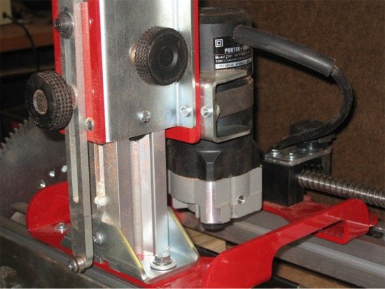

This is the head stock, which holds your router, can be locked in place and left loose to follow the Z axis cutting.

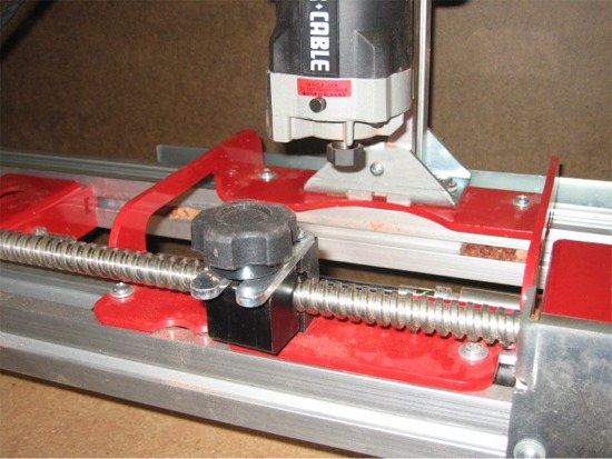

This is the spiral pitch lock. When tightened, it will engage to cutting carrage and move the router down the stock. When left loose, you can manually move the head stock to cut flats and other work.
