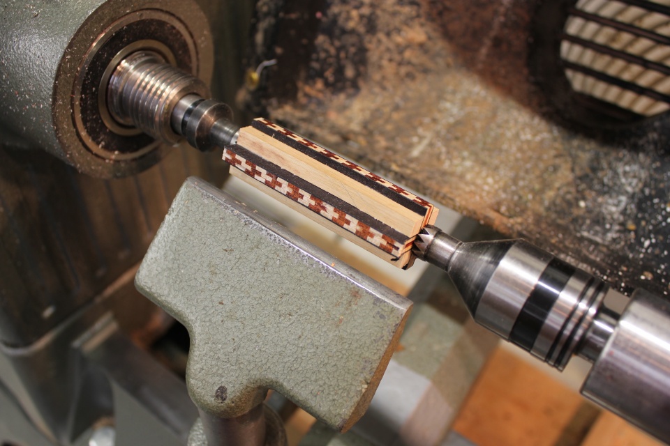

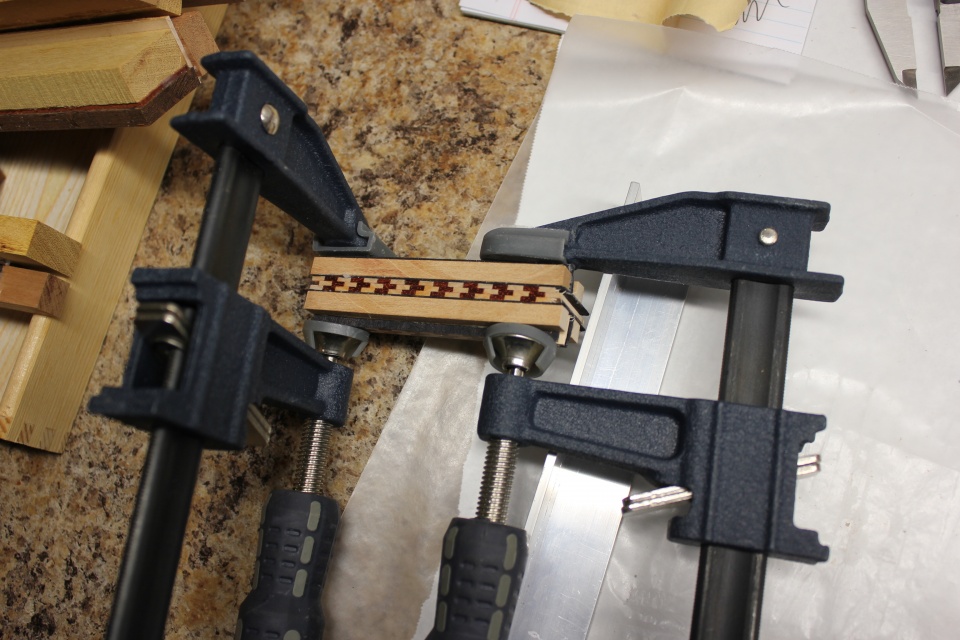

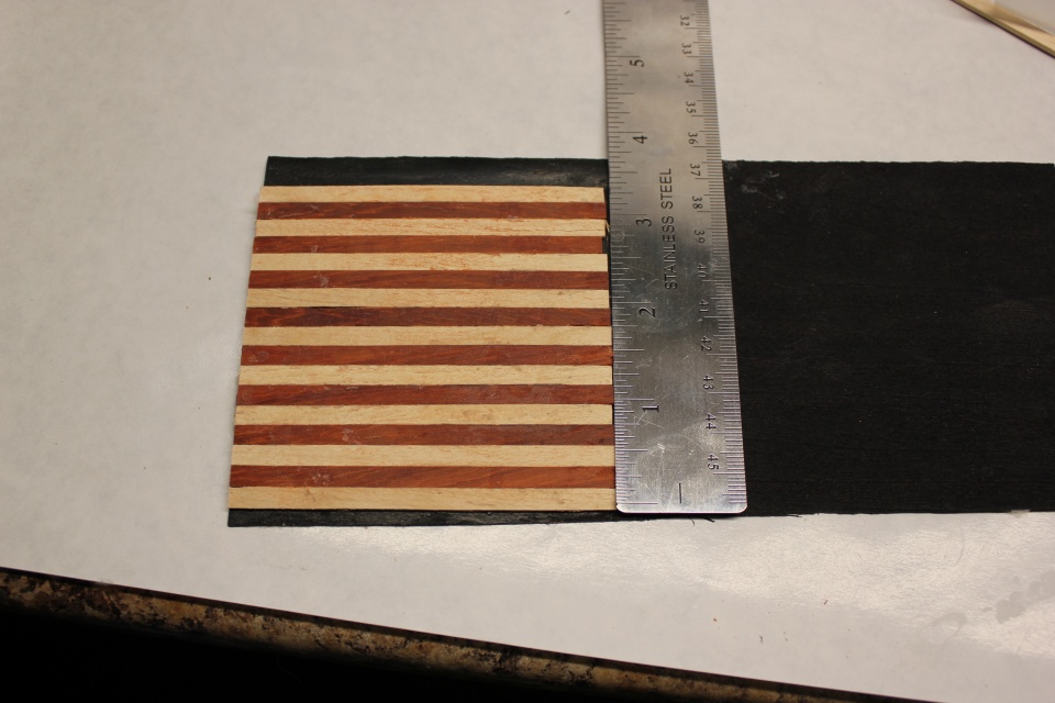

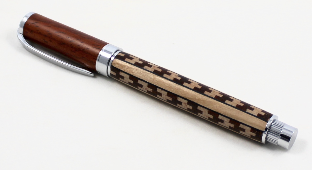

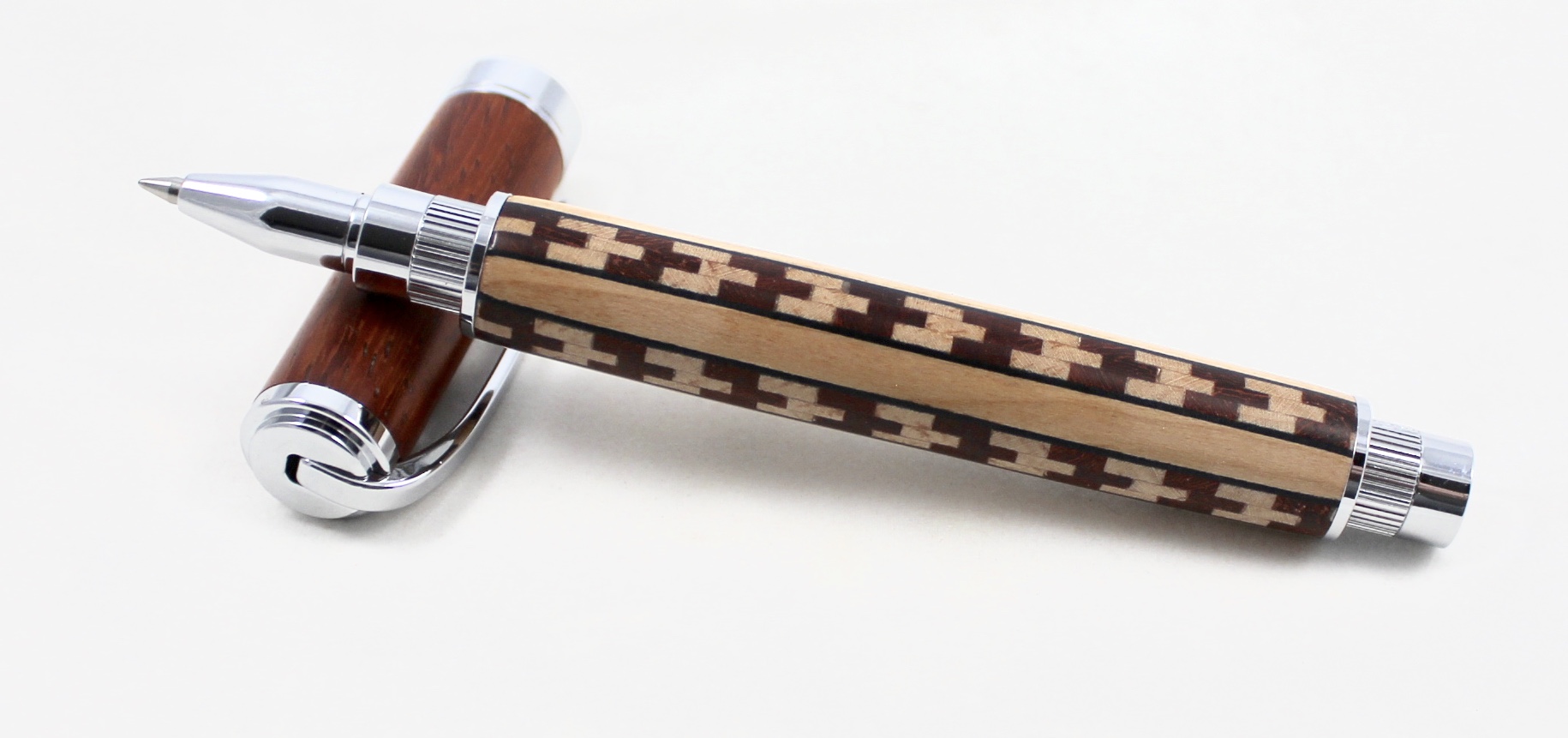

This is a "first attempt" at a new design. Future renditions will go for thinner strips, and 5 strips per inlay. This inlay used leftovers so I did not mill them thinner. The inlays have 2 black veneers (.021" x 2 = .042") plus three layers of Padauk and Maple (or poplar, not sure?) (.0625 x 3 = .1875"). 5 Ply inlay is .2295" plus epoxy.
The alignment was decent for a first attempt. It is a 4 sided inlay (as my previous ones). I just don't like having 2 sides with the design :cool:.
Comments, suggestions welcomed.

Gees mate, you are certainly getting some amazing creation juices, that's a lot of work but, it looks amazing, congrats.

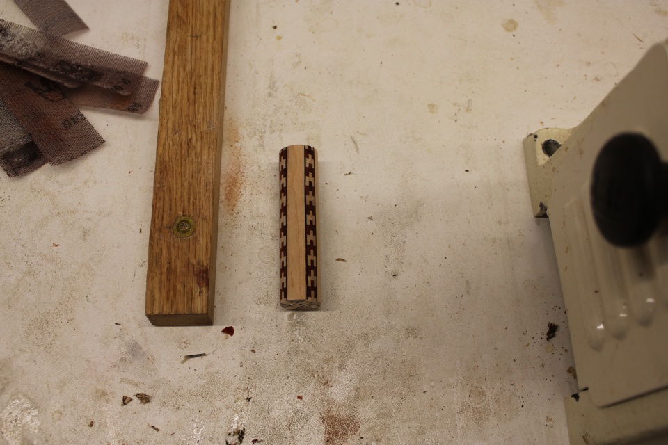

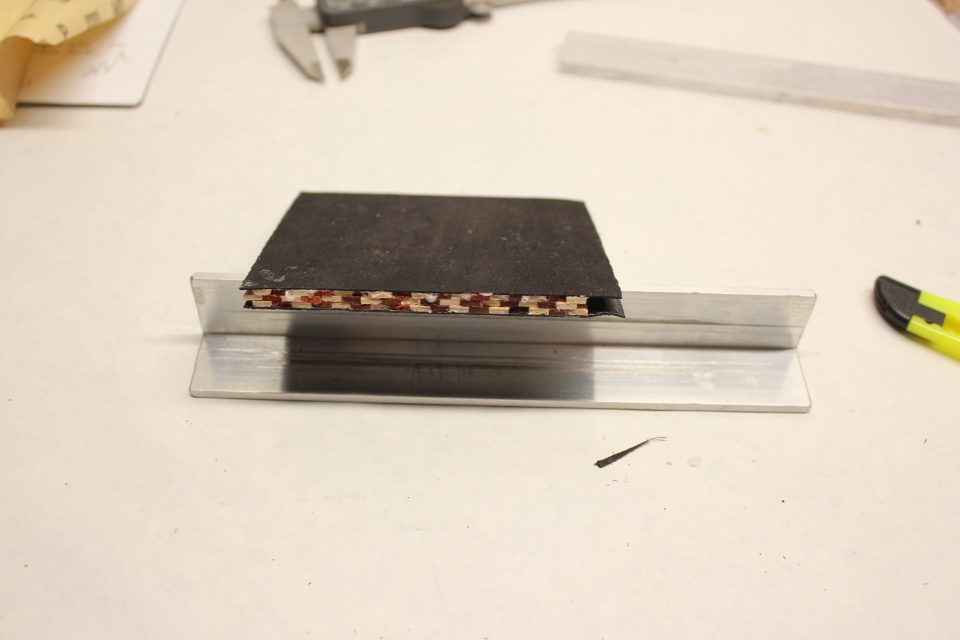

Have a pic before turning?
Sure, You should have a go at this! I love your work also.
As an explanation, while I love the complexity and skill set needed for blanks like the "Gisi" style, as well as other segmented works, I have not always liked that the patterns are seen on 2 sides, and the alternate sides are "plain."
I like having the patterns on 4 sides; but this limits the inlay to about .25" thick - my pallatte is pretty narrow. For this design, I should have little problem getting 5 layers, as the strips need to be sanded down to about .04" (5 x .04 = .2" plus two veneers 2 x .021 = .042" for a pattern of about .242").

Great work, Mark !!! . I can't understand why I didn't see this yesterday when you posted it.
The pen looks beautiful !! . Innovative design !!
Beautiful work Mark, like the pattern.

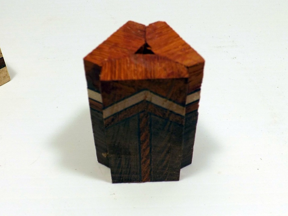

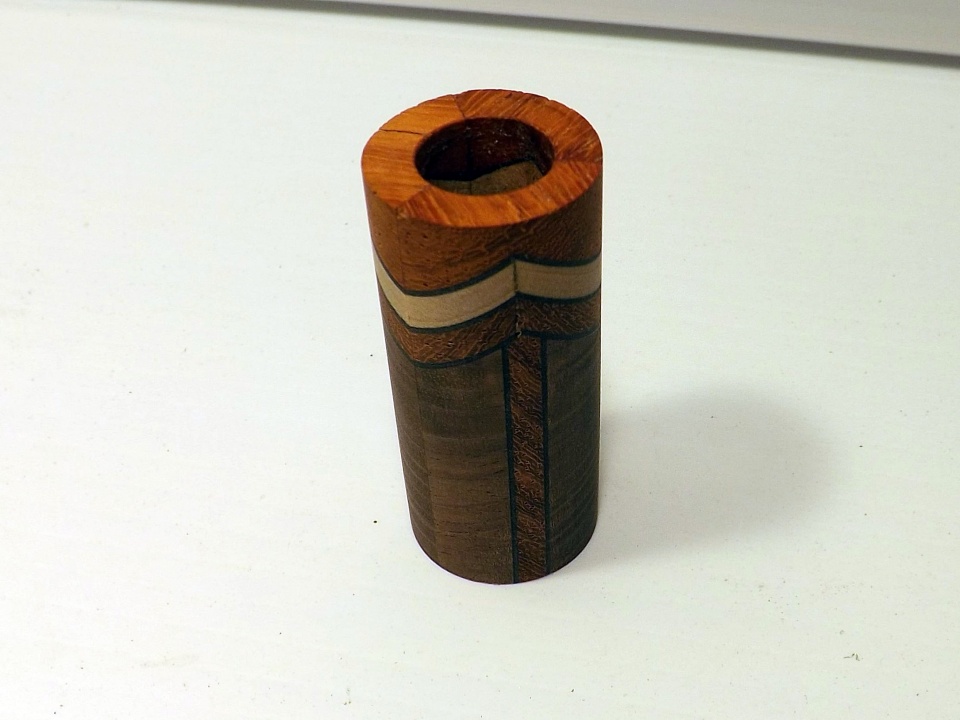

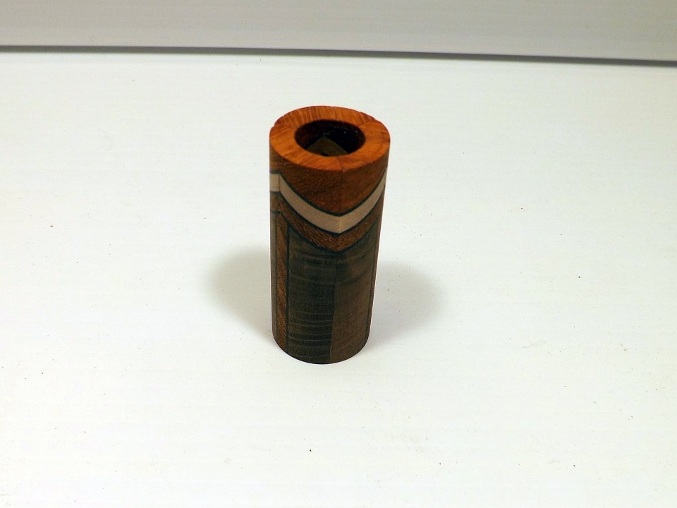

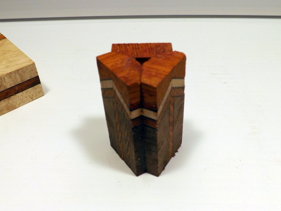

It's funny that you mentioned leftovers and the Gisi only having two sides. Been playing with a variation that would give it more than two faces. Had some pieces left over and glued them up last night. Will be interesting to see how it turns out.

Ohh Ahh... Sweet! I love the input/exchange. I have no critique with well made "Gisi" style; I just like a 4 sided patterns better, my opinion only, even with the smaller ava space. Now you are exploring a 3 sided... NICE, This should be worth the wait.
