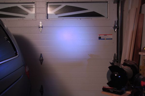

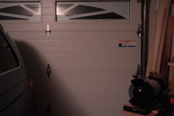

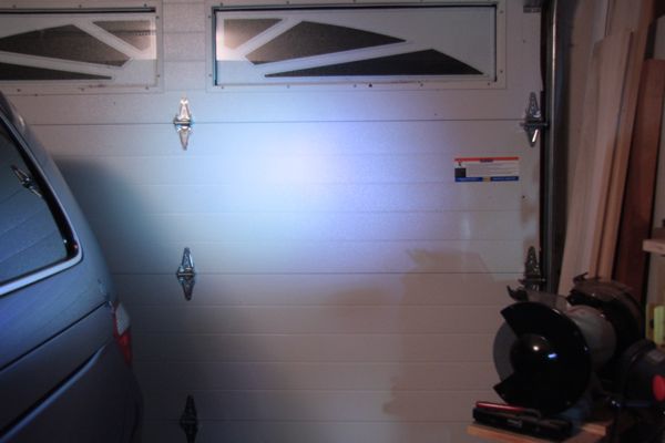

The first set of photos has both the original light and my modified light mounted next to each other on the lathe and pointed at the garage door 8 feet away.
First with no lights:

Then the stock light:
attachment.php

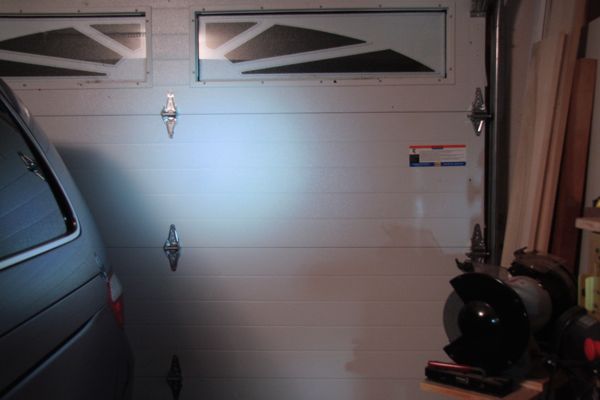

Now the new version:
attachment.php

Notice how the new version is brighter, wider, and less blue.

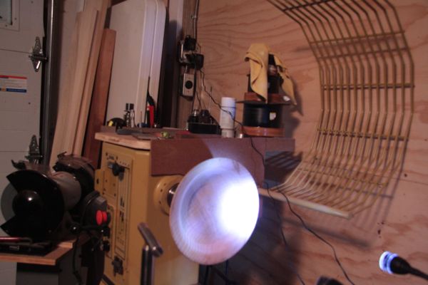

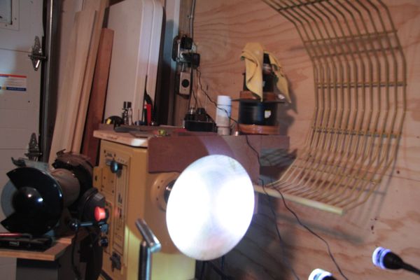

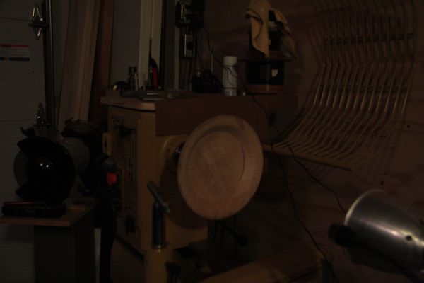

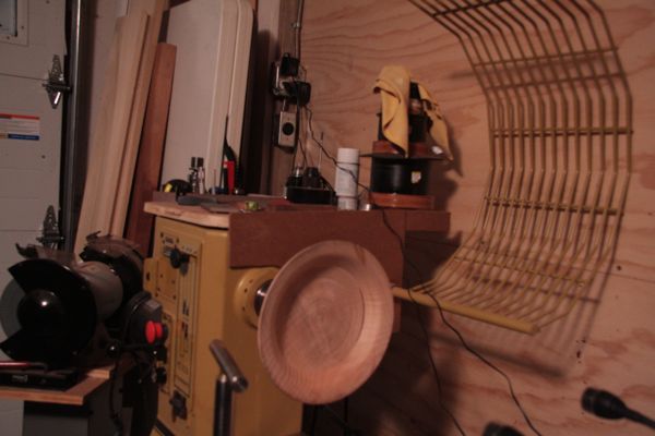

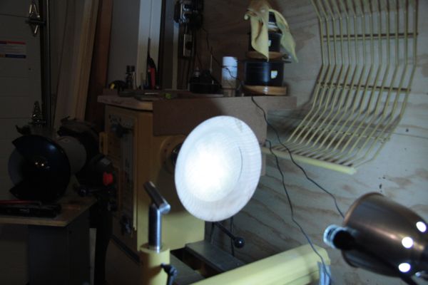

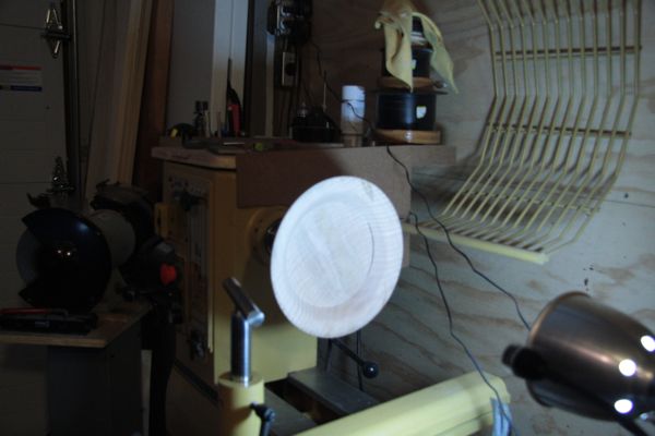

Now for some photos "in use". These are mounted on the lathe pointing to the same "relative" area of a maple bowl chucked up 2 feet away.
No lights:
attachment.php
Original light:
attachment.php
New light:
attachment.php
And finally both:
attachment.php
You can really see the wider spread of light. It is also brighter and yellower, although the photo really doesn't show that well.

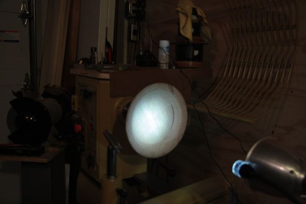

Lastly, a few photos to compare the newer, stronger LED to a relatively modest 20w CFL in a cheap reflector.

Then with the LED:
attachment.php

You can see that the LED light is much brighter but has a much much narrower beam.
I think the LED light would be good on a drill press or scroll saw where you only need a little spot of light but on something like a lathe where you want the entire piece you are working on lit up, the CFL is the better choice.
