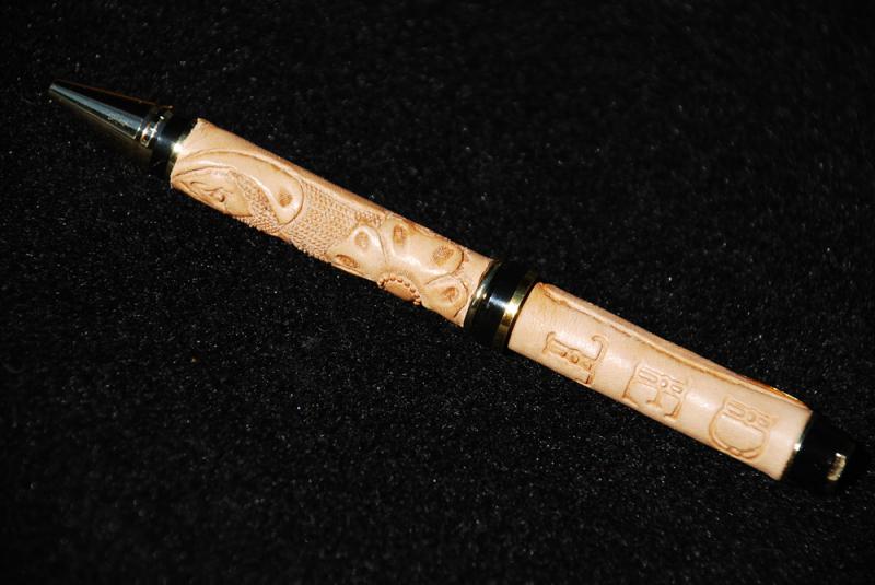

This needs to be modified a little but it should attract attention from some body.
John:
Interesting pen. I think it looks very nice. May I ask; do you seal the leather? i could see the benifits of sealing or not.
Thanks for sharing.
Steve
This one is not sealed. The next one will have oil as a top coat.I am relying on lanolin to add to its appearance.
Awesome :cool:work love the idea I have done some wrapped in imprinted leather but never tooling leather.what size (oz) weight tooling leather is that? did you wrap and glue it or stich it in a tube then glue to pen tube?
I used a medium CA that allowed for 30 secs. to arrange the leather onto the tube, then placed into a press for the night to seal the seam and form the leather. I made the form out of the white cutting board material.
Thank you for your interest.
Absolutely beautiful pen John. Your use of CA caught my attention, because I would have thought that the leather being porous would not provide a good substrate for a sufficient bond. I'll put that one into my databank for future reference. Thanks for sharing.
