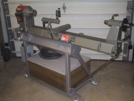

Check this one out!
It is maybe more than you had in mind. This guy spent weeks designing and building this stand.

The guy that built that stand knocked it out of the park!

That looks like a well thought out solid stand. I might have gone that way if I hadn't already bought. Got my lathe set up and ready to go. Now just have to find time in between Tee Ball practices to use it!
