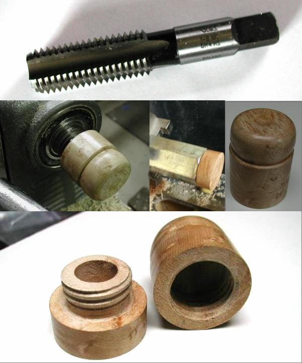

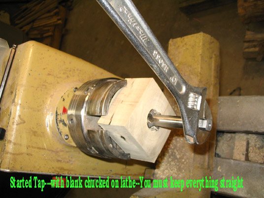

Several of us have bought Lathe Spindle taps. I wanted to start this thread to show off some of the things that we are going to make---heck that sounds real positive---lets see what we can come up with.

Ok it's Sunday morning and I hadddddd to give this a shot.
1st one ended up as firewood-----

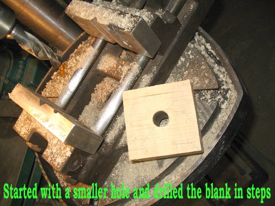

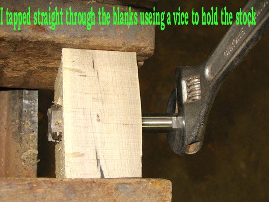

The thing I changed was moving the stock over to a vice and tapping straight through. This way I did not have to try backing the tap out. I ran the tap through the hole a second time by hand just to clean the treads up and make sure it felt good.

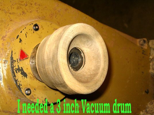

To remove the chuck from the lathe-----small oil filter strap wrench works perfect.
Also made another one-----2 1/2 inch.
Here is the reason for doing this.

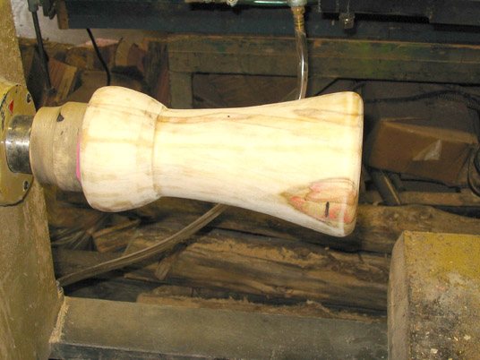

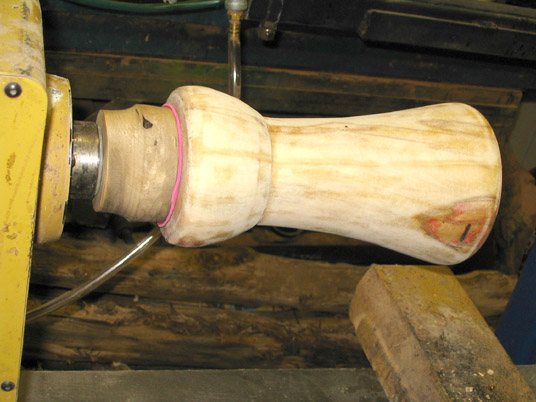

I needed to finish this vase----I can do this fast on the lathe if I have a way to hold it.

Gary,
If you engage the tailstock while tapping on the lathe, it will help you square it faster (especially the initial part which is the most critical). I know you will have to crank the tailstock wheel too while tapping but I believe it will work.
I just ordered mine so it isn't here yet.[8)]
Yup:
What Dario said is right on the money. There is a dimple in the end of the tap for your tailstock to hold it in line. In fact, it tells you to do exactly that in the instructions that come with it (yeah, I read those every once in a while).
I used the tailstock to help keep everything straight and push the tap through the block---I never turned the lathe on---this only takes a minute to do by hand.
When the tap hits bottom I moved it over to the vice and a couple of turns and it was out the back.

Thanks for taking the time to walk me thru this. I appreciate your input! By the way, I'm also trying to make a 3 or 4 inch drum for my vacuum chuck.

I used the bottom tap from Grizzly to make the box. Not sure a tapered tap would work in that application. The outside threads were done using a mini-metal lathe with a laminate trimmer attached and a 60 degree V-bit in the chuck.

Chuckie you hit the nail right on the head. That's what I want to make---small wood boxs with screw on lids. Cutting the outside treads is what I need to figure out----I aint no machinest. The rig they sell over at Beall uses a router with a jig to cut them ---I think that's how it works.
