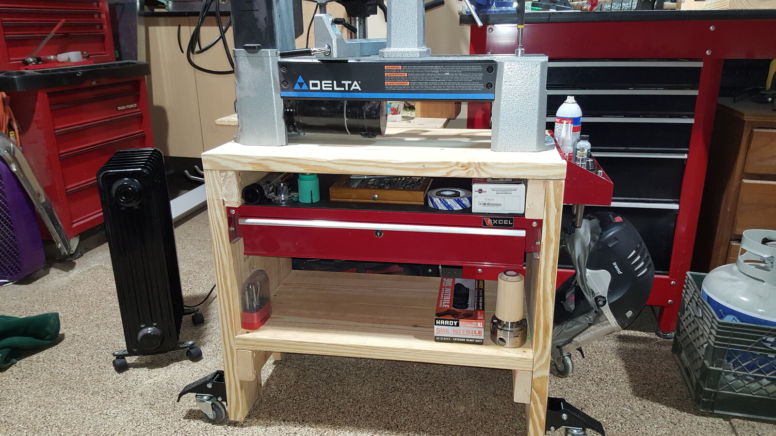

My dad (87 years young) loves to turn bowls and he just replaced his Rikon with the Laguna 12/16 earlier this year and he's really impressed with it. They are selling for $799 here and I just missed a big 10% off sale but there will be another I'm sure come the holidays and I should have enough penny's saved up by then. It should fit on my mobile base I made for the Delta just fine. I just hope I have enough non-turning projects to keep me busy until I can replace it!
