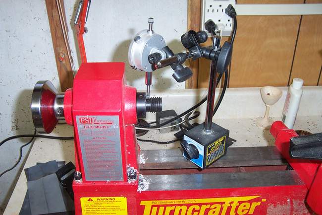

I do have the dial indicator and holder from Harbor. I'm not sure where to check the runout. If I check it at the location in the picture the run-out is just slightly less than .002. How much is too much?
<br />

I am also experiencing the same as Steve. I, too, hooked up my DI that I use for my tablesaw and the runout on my Jet Mini was not measurable at the headstock. I then went and bought a new mandrel. The problem persisted. the new Mandrel it dead on straight. Less than .002 at the end of the mandrel shaft. HOWERVER!!!.... I am using the stock live center that came with the lathe. When looking at the center, the point is a little chewed up.
