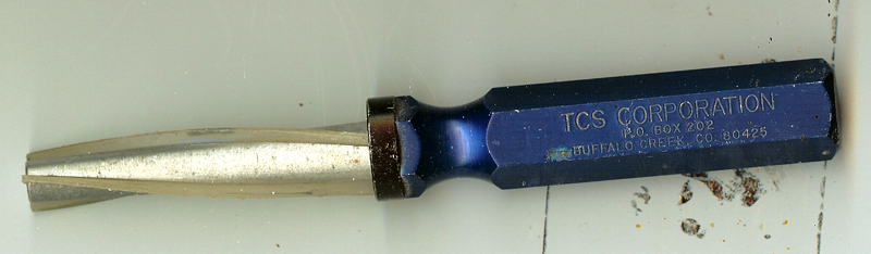

Is it a morse taper mandrel? If so, check to make sure that the taper is clean, but the female portion in the lathe, and the male component on the mandrel.
Do you have one of these? It will clean out the taper.

I forget where I got mine, might have been Little Machine Shop or someone
like that. I think it was around $10 or less.
