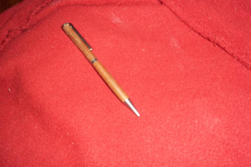

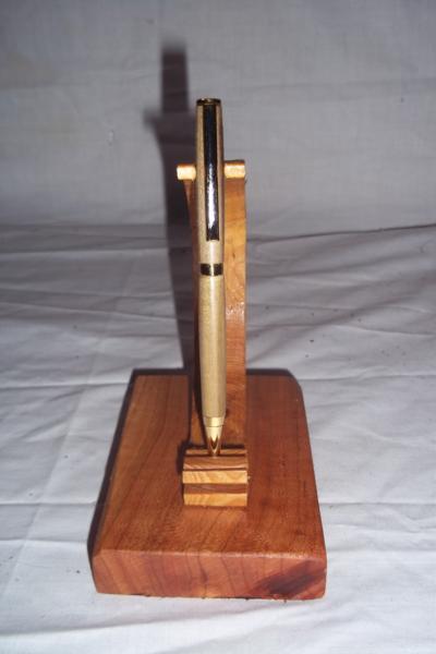

Hey all, i am new to pen turning, so far i have made 2 a walnut and a poplar, but i am in need of some help... today when i started to turn a cherry pen when i put the tool against the blank it would stop the blank from turning and a loud squeal. Could the belt be loose?
I didnt have this problem with the 1st 2 pens
thanks in advance for the help
below are the pics of what i have done
