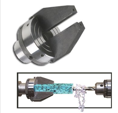

I use The PSI blank chuck to drill wood and Acrylics on the lathe. Lowest speed and drill slow....have not had any problems with blanks breaking.
I would continue to drill short and cut off the end. I don't see how a collet would prevent blowouts. The collet will not provide support on the bottom of the blank, only on the sides. The bottom of the blank is the issue with blowouts. If you do not have enough material to drill short, you could always glue on a sacrificial piece of wood/acrylic on the bottom of the blank.
