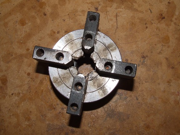

I drill almost exclusively on the lathe... my DP is a HF desk top and only has a short quill travel... I can do a pen blank faster on the lathe... I use a little chuck from PSI with some square bars that holds the blank... I don't round the blanks before I drill, then after they are glued up, turn between centers...
just mark the center points on the blanks, put the point of the drill bit in the center mark, close the jaws and drill.... I've also drilled antler the same way... you just have to make sure the bit will travel through the blank and not through the side (been there, done that too)...
