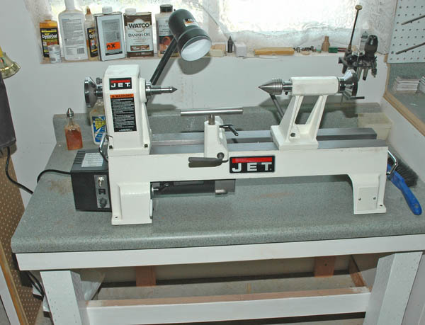

It seems to me that a 3 1/4" top is overkill. Here is a picture of my lathe bench, it is just a piece of countertop on a 2x4 frame which is anchored to the wall. Solid as a rock.

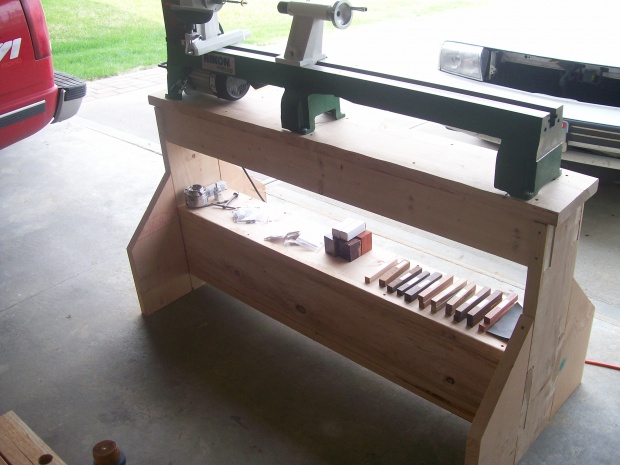

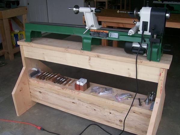

Good luck deciding what to do. Here is what I did. The bottom "box" is filled with sand so the total weight of the stand and lathe is somewhere between 350-400 lbs. It was a very cheap build.

LOL...two opposite ends of the spectrum there. I'd like to fit somewhere in the middle! I do plan on making some small hollow forms and bowls, but nothing that I think would require the behemoth that Wheaties posted.

I agree that's overkill unless your intent is to dampen vibration. That sounds more like a workbench than a lathe bench.

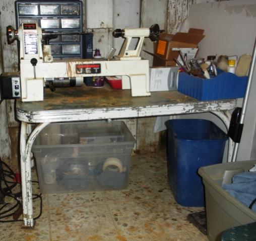

I've used a "converted" dining room table for a few years now. If the support for the table top is sturdy, I don't see why you can't make do with your drafting table. Here's my lathe table. It ain't pretty. But it works.
